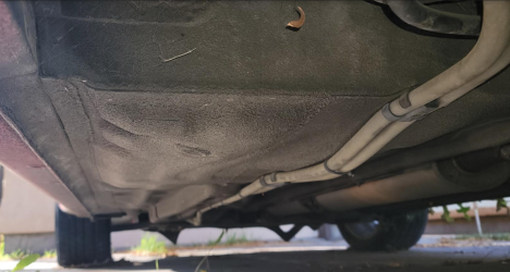

Pretty decent price on 2/0 gauge wire. not quite as flexible as KnuKonceptz, but price similar to their 1/0. Very good all strands tinned, fine high strand count OFC copper. I run my power/ground installs under my car, no loom needed.

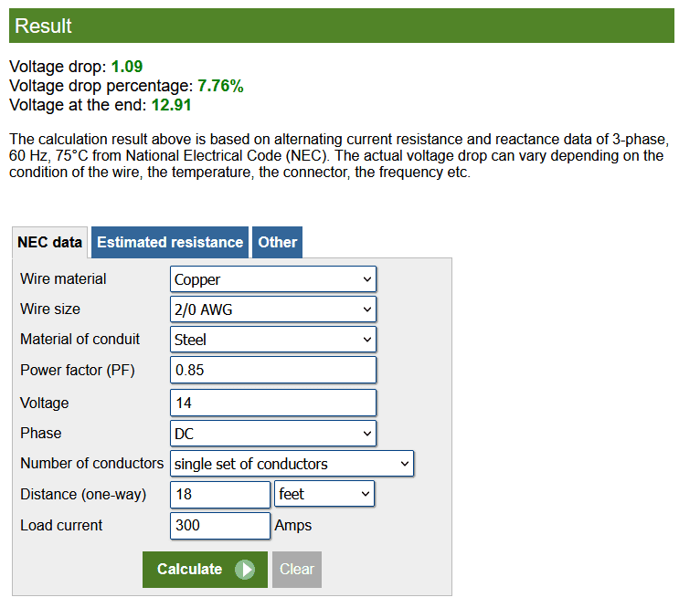

I would also consider parallel grounding in this instance.
https://www.bestcaraudio.com/car-audio-myths-you-cant-ground-a-car-audio-amplifier-to-the-battery/

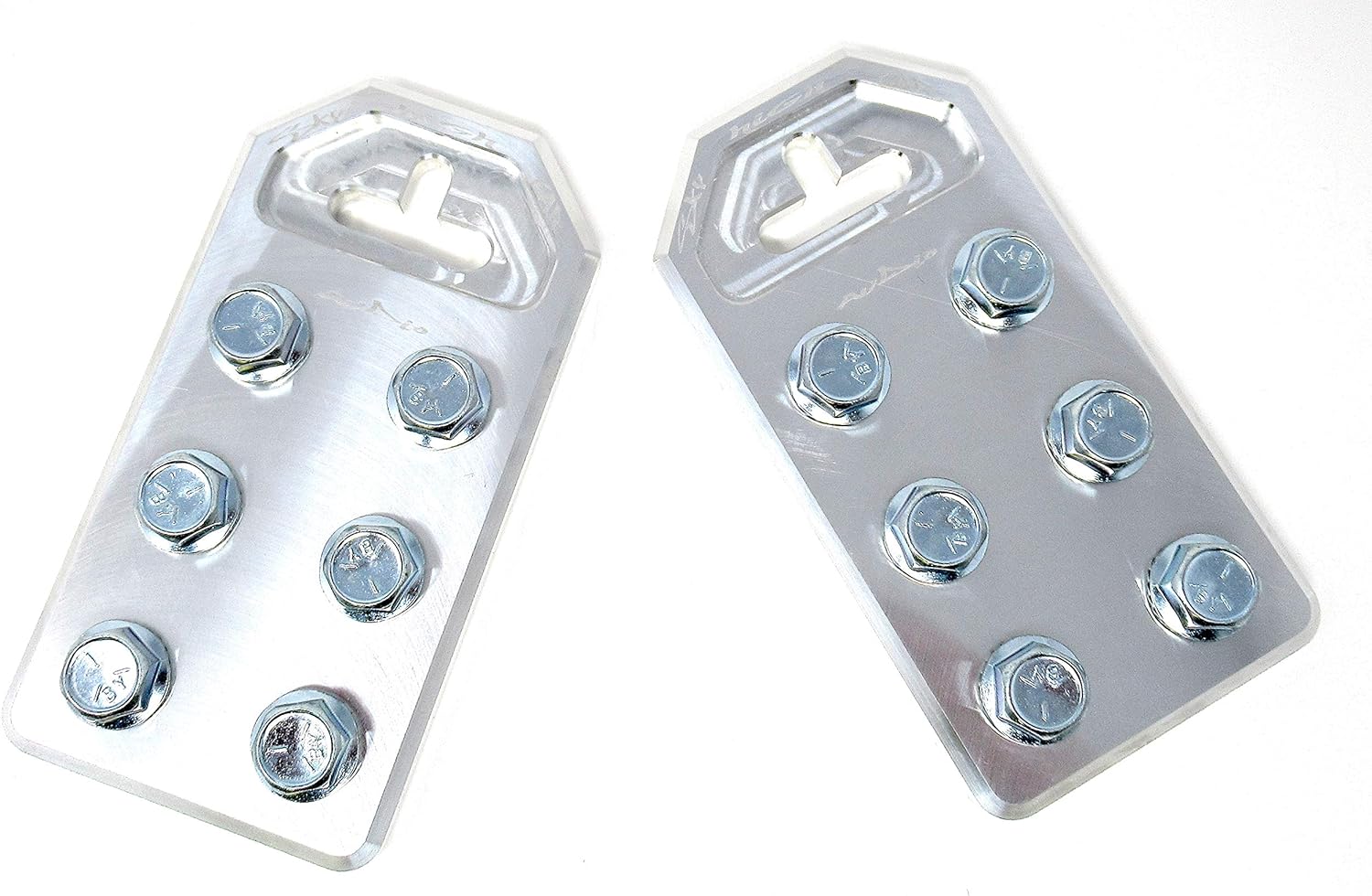

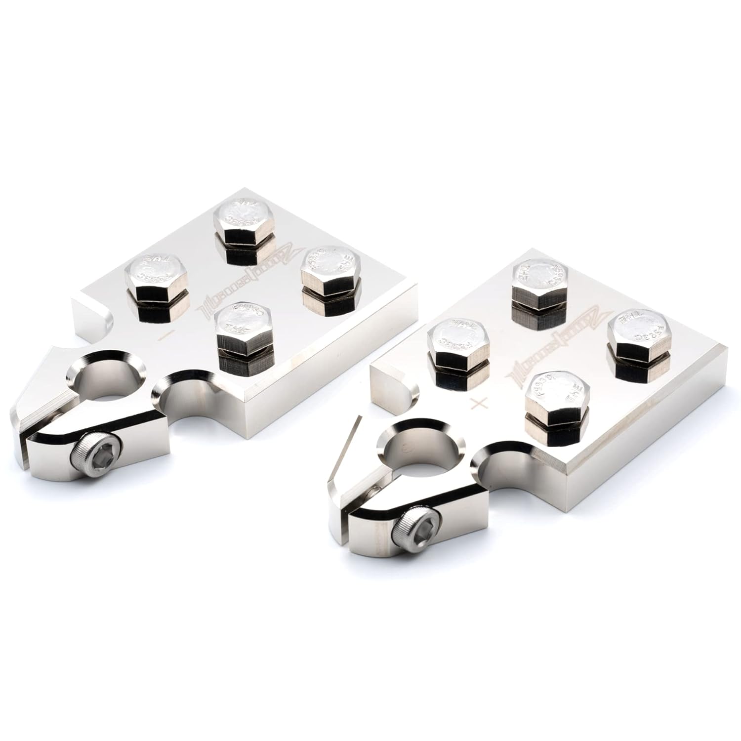

Yes there are several similar styles.
Here is what I use. I originally had side mounted terminals, and liked the design, because the first style I used, would spin, and these were balanced.
Amazon product ASIN B07T9G2FZF
You can find them with two and I want to say up to to 10. Search the amazon pages, and you cna find quite a few similar styles.
The only ones I would say to avoid are the SKY HIGH terminals like this:
The set screw (to secure to the terminal) is really small, and won't even hold if you mount em flat to the top. Not a chance if you mount em to a side terminal.
