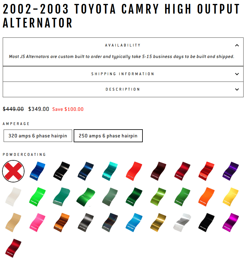

J&S does great work, fast, reliable and the customer service is excellent. Every other company I tried to get one for my Ford 4G Explorer gave me a run around. Some couldn't even get their answers straight enough to lie decently. J&S was straight forward from the get go and the pricing was awesome 379 for a 320 amp alternator and had options up to 400 or more for it. Even Apex gave me the run around as well.
I'm running a J&S 320...no complaints or issues with mine
This is from their site:
