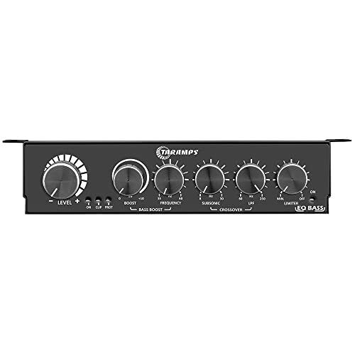

Yes, they do. As for the Taramps remote control, it is for use with the EQ they sell, not as a remote bass knob. They are not very sophisticated and are just your basic attenuator pots. They are available on eBay for like $8. I generally don't use remoter BASS knobs; well not since I started using DSP units. There is a guy out on Mercari (an established seller), looks to be selling a new one of these for $379, shipped. He is apparently allowing offers too. I'd offer $350.00 and if comes back with $379, still a great deal - heck, if it's still out there in a couple of weeks, might get it myself, just because!!! With that kind of savings, you could purchase a remote bass knob. Generally, while the remote knobs might be convenient, most attenuation on a HU that has subwoofer out makes them a bit redundant.
https://www.mercari.com/us/item/m54...BFQ_VZJzueX5O8fumJyDPcOLYl30RSt0aAhqQEALw_wcB
If you must - Taramps BASS knob:
https://www.ebay.com/itm/2349906698...d=link&campid=5335951755&toolid=20001&mkevt=1
Better - If you like the use of a good bass remote, then one of these Taramps that incorporate and EQ and volume control would work nice for $53.00.
