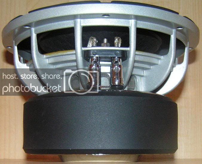

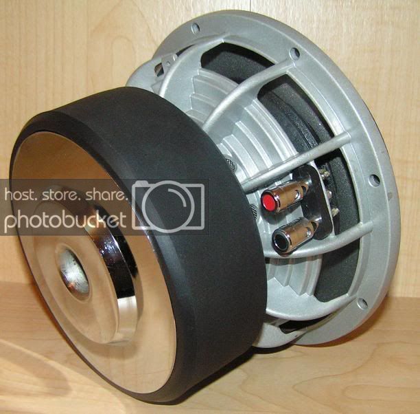

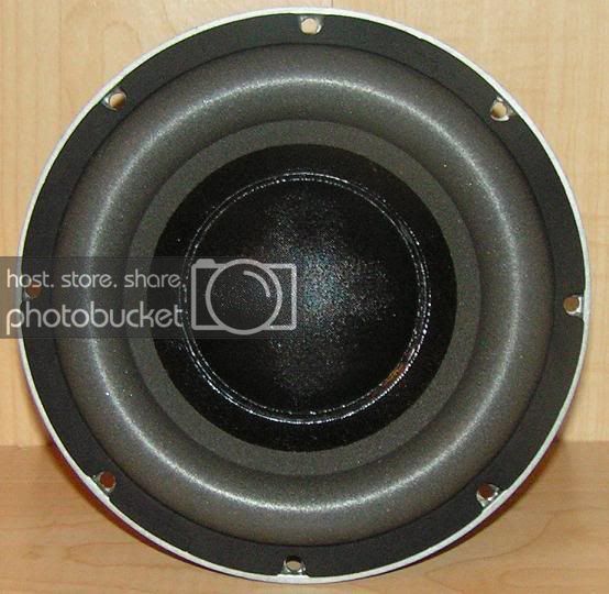

They use a 2.5 inch dual 4 ohm copper voice coil, a copper shorting ring, 2 layer foam surround with heavy duty pressed paper cone, a large 6.5 inch spider with integrated ribbon tinsel leads, and a double 1 inch thick stacked motor with a bumped back plate and pole venting.
Here are the t/s with both coils in series no break-in.
revc 8 ohms
fs 40hz
qes .44
qms 3.58
qts .39
vas .252 ft^3
bl 22.6
sens 82.8 1w1m
The low vas means these subs can work in a very small box with good results. The WMD8 will only really shine ported and sealed enclosures are not recommended. I recommend .5 to .75 per sub tuned to 40hz.
