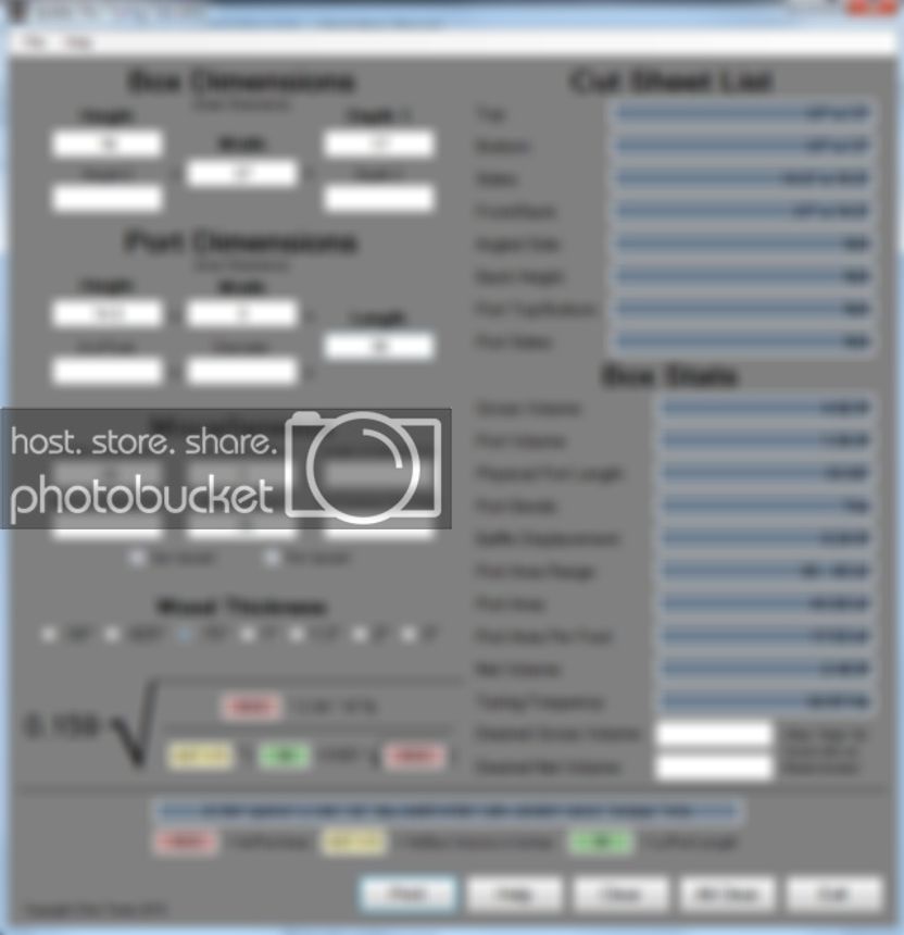

Someone that knows more than me tell me how this looks before I build it tomorrow and it makes me sad. Will be for a single 12 on about 3k RMS in a 2 door Blazer. The only thing I am not sure about really is how much port I should try to shoot for. Would love to hear what you gurus would do differently and why.
And Ignore the "port upward" that is ticked, it will actually be sub up port back, bleh //content.invisioncic.com/y282845/emoticons/frown.gif.a3531fa0534503350665a1e957861287.gif

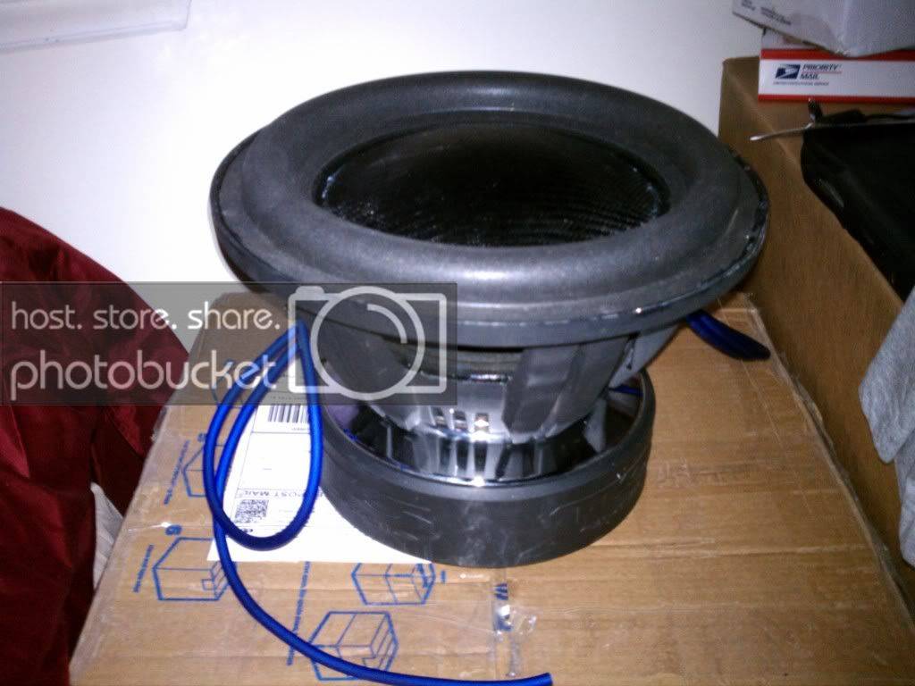

Beefy? I have seen bigger 8's //content.invisioncic.com/y282845/emoticons/eyebrow.gif.fe2c18d8720fe8c7eaed347b21ea05a5.gif
It's not that bad //content.invisioncic.com/y282845/emoticons/frown.gif.a3531fa0534503350665a1e957861287.gif Def not the beefiest ever but a 46lb 12 isn't too bad. All the parts in it are quality at least //content.invisioncic.com/y282845/emoticons/smile.gif.1ebc41e1811405b213edfc4622c41e27.gif

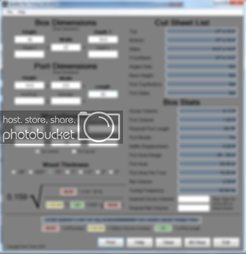

Thanks guys, I'll drop it down just a little and see what I come up with. Thanks for the suggestions and taking a look at it. Not the first I have built but it is the first I have tried to design.

Seems like a lot of port area per cube...but I don't know that much on designing just the "rule of thumb" is 12-16 square inches per cube. RAM would know better than I.
Port area is definitely bigger than normal, but the stiff suspension should help keep things in check pretty well if it needs to play down to the mid 20's. I agree though, I'd shrink it down some.
Thanks again guys, messed around with it a little bit and I think I'll give this a shot.
