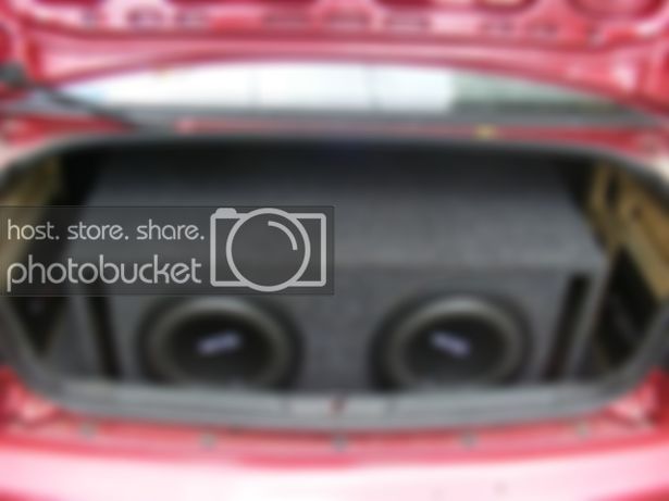

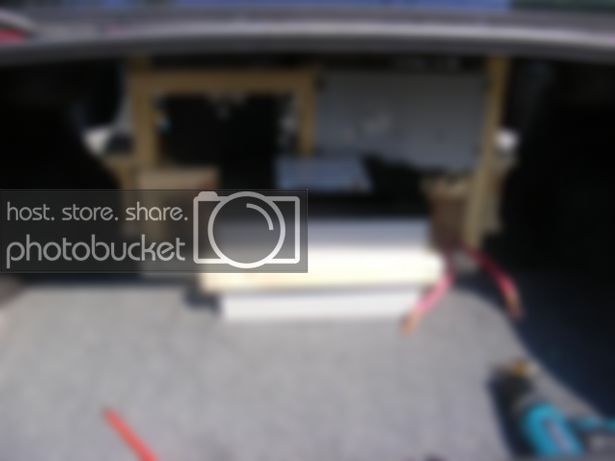

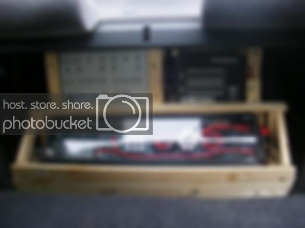

ok got the biggest part of the install finished. only thing left to do is the carpet panels. here is a few pics. battery set up, amp/processor rack (visible when rear seat is folded down), and the subs.
