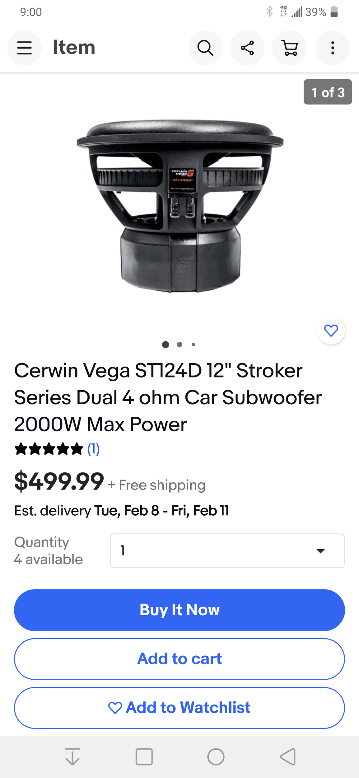

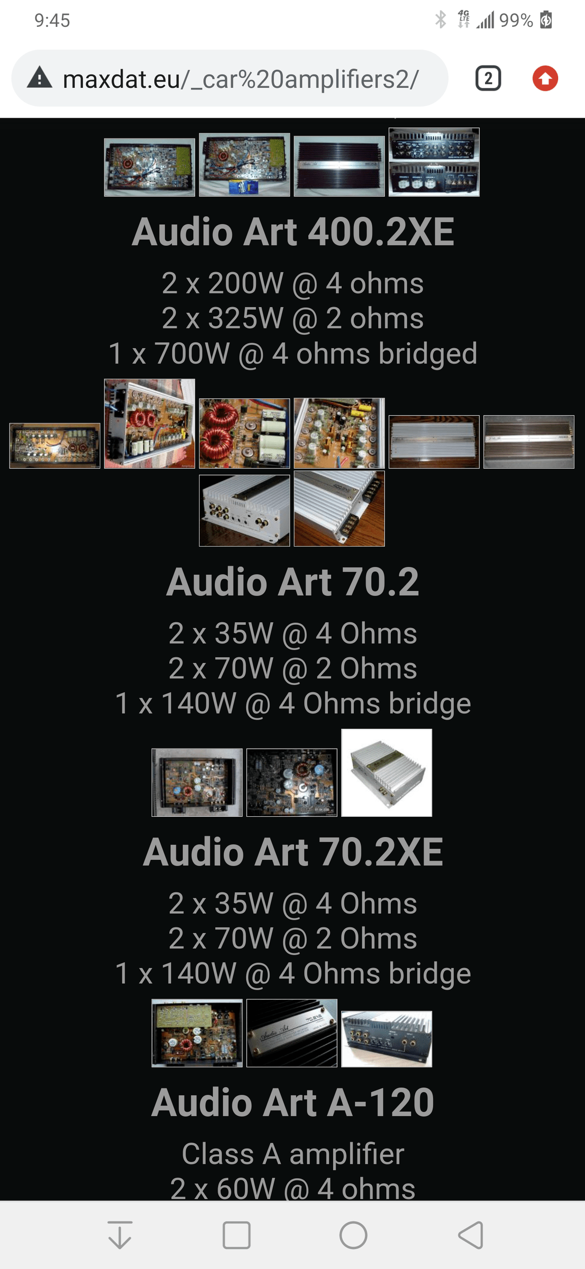

2 cerwin vega strokers.any info will be helpful thanks.
I highly doubt it. Audio Art is made for SQ applications while CW Strokers are SPL oriented. It would be like making garage sale posters with a calligraphy pen. Are they the OG Strokers?
The subs are old school cv 12d2 dual 4 ohm
Wire them to 4 ohms for the pair and that amp will run them. Not to full potential, but will run them wired to 4 ohm Bridged on the amp. The subs will perform much deeper and at full potential wired to a final 1ohm load, and you would need to find a mono amp to handle a 1ohm stable final load. But be a great front stage SQ amplifier no doubt if it works well also
