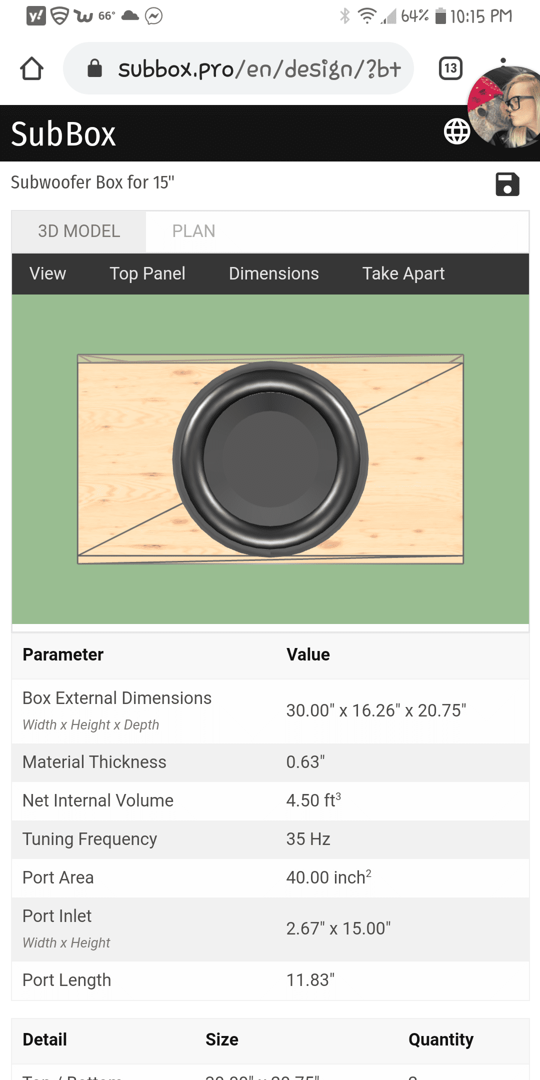

You may have to go into the trunk at an angle ... you wont be able to do ported or vented ...so really the vhf only choice is sealed . Youd need a 3 cu ft sealed enclousure with a double baffled front at about a 45 degree angle so you could install the sub . If your mounting the amps on the rear of enclousure . The rear board would need to be double baffled as well and mount amps to rubber isolaters to prevent damaging vibrations to the amps circuit boards ....
Thanks i did build a ported box. I will post specs
