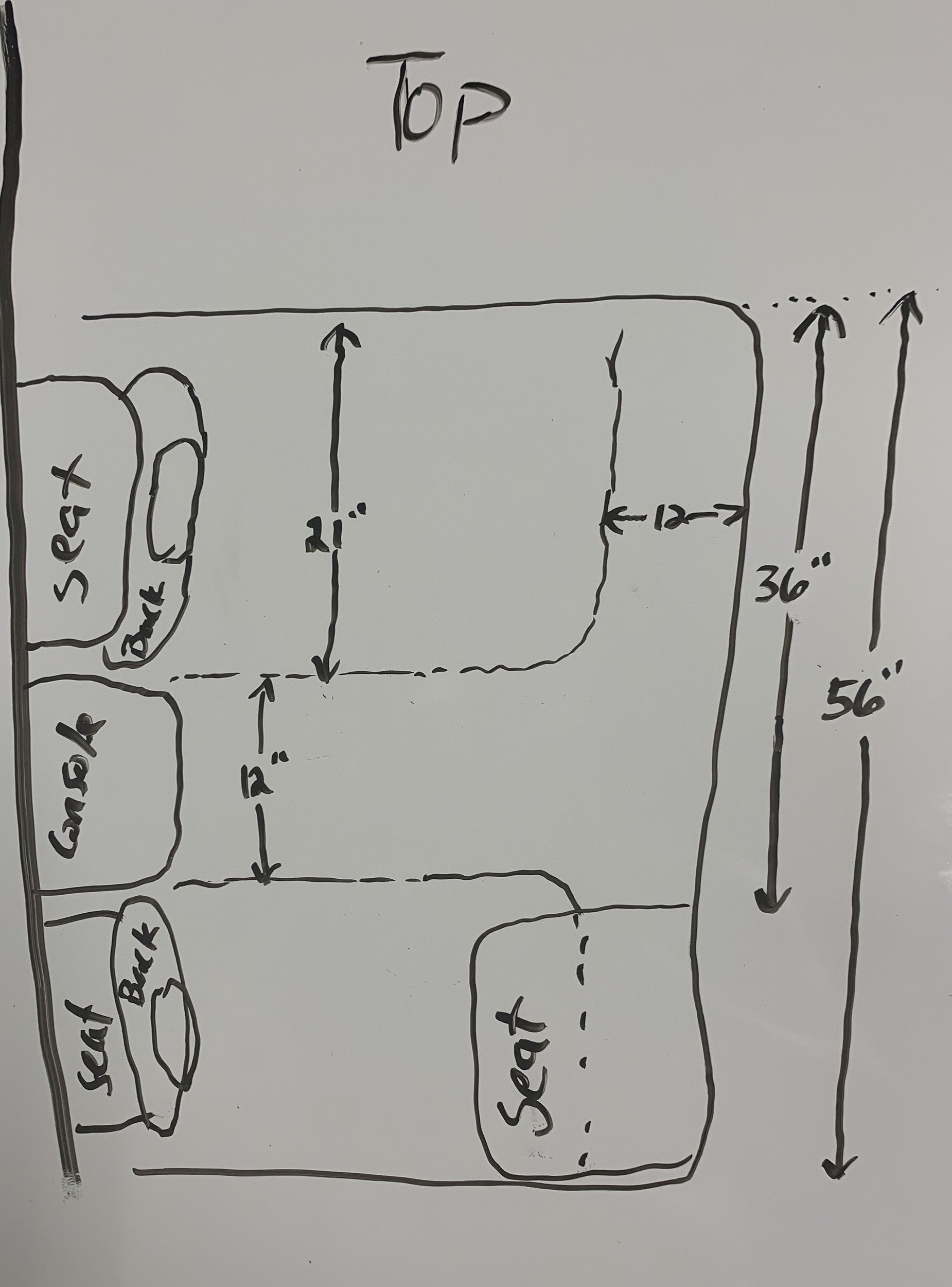

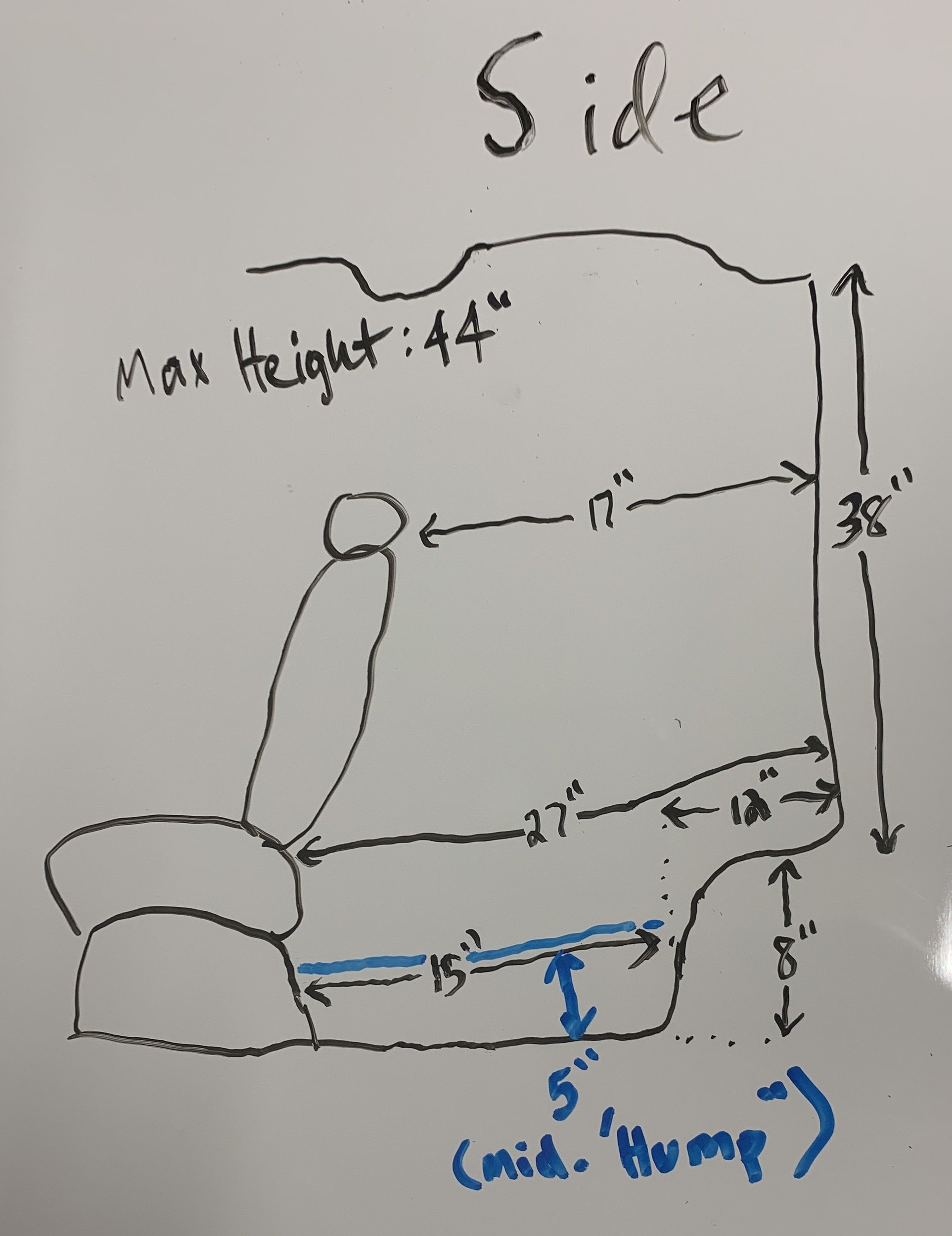

Alpine mrx-m240 is the amp so was going to run em series / parallel ending at 2ohms. Space is lil tricky to explain because of the contour of floor and all but I’d like to keep it narrow enough to only have out the 60% side of my back seat (passenger side). But if I have to use the whole back area I will.
attaching side view of the area and top view
Is the rear seat removable for this situation? To me,because of the size of box you'll need to get those to really slam, I'd suggest building a wall and using a false floor. Would be a little easier if you had 12's.
