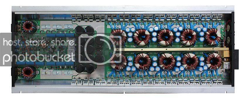

Here is a picture of the 20kw 12v model-
Thanks for the additional info. For what it is worth, you have an error in your prior post. Full Bridge and Half Bridge class D amplifier topologies have nothing to do with "rectification". You should remove any reference to rectification in your prior discussion. Full Bridge and Half Bridge refer to single ended or differential drive arrangements on the amplifier output stage.
