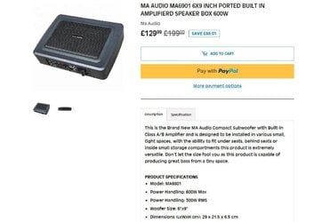

Power still going to the sub as the light is still on.
I assume this means you have a powered subwoofer and you spliced in the high input harness from the sub into the speaker outputs. Generally this would not harm the radio since the high input presents a higher load than the speakers. Try disconnecting the subwoofer module for testing.
What brand HU do you have? What subwoofer do you have, and is it being powered by a separate amp?
The existing HU is probably beyond repair if its internal amp is kaput. It is a KDX R-03JBT. RMS 4x25W. Sub is an active one with its own internal amplifier, image attached. No separate amp.

Time for a new head unit upgrade. No sounds technically means bad speakers, bad head units, or bad connections. Electronics and technical term no sounds could mean many or any of the above. Irregular signal inputs and peak amplitudes causes no sounds. Volume. This is called a DC offset. 12 volts normally above zero, yet at irregular intervals. Old radio, junk speakers. Are the causes for a DC offset. Time to replace some components then.​
