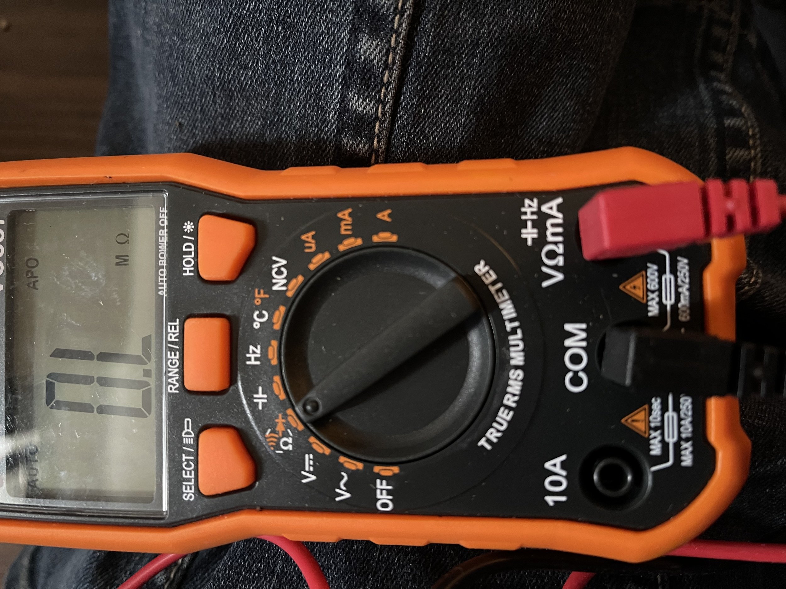

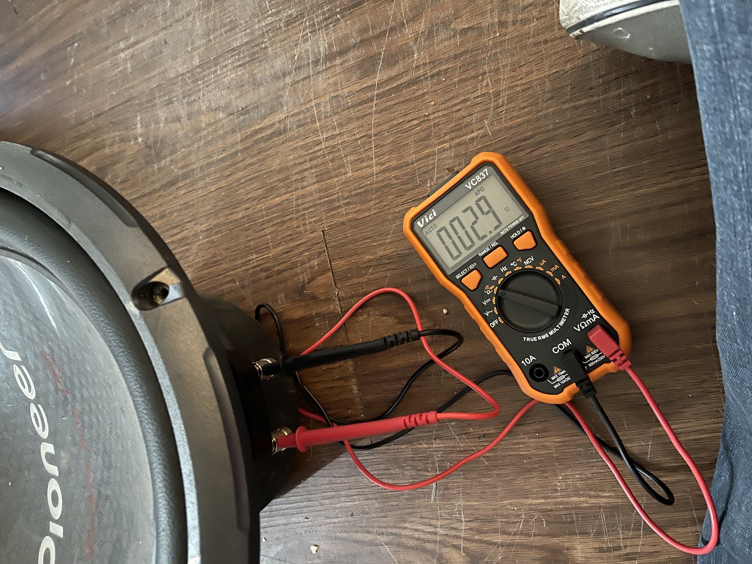

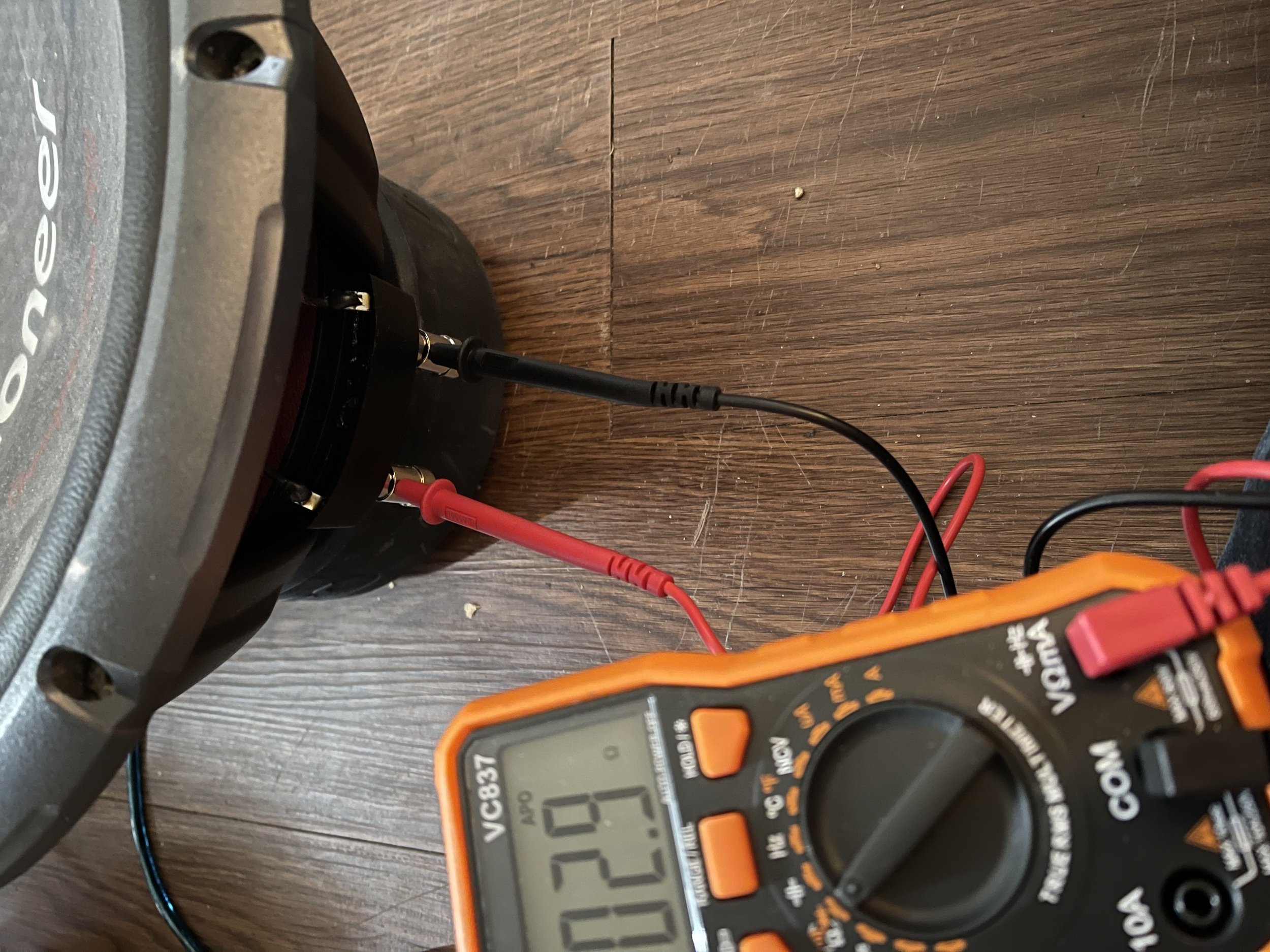

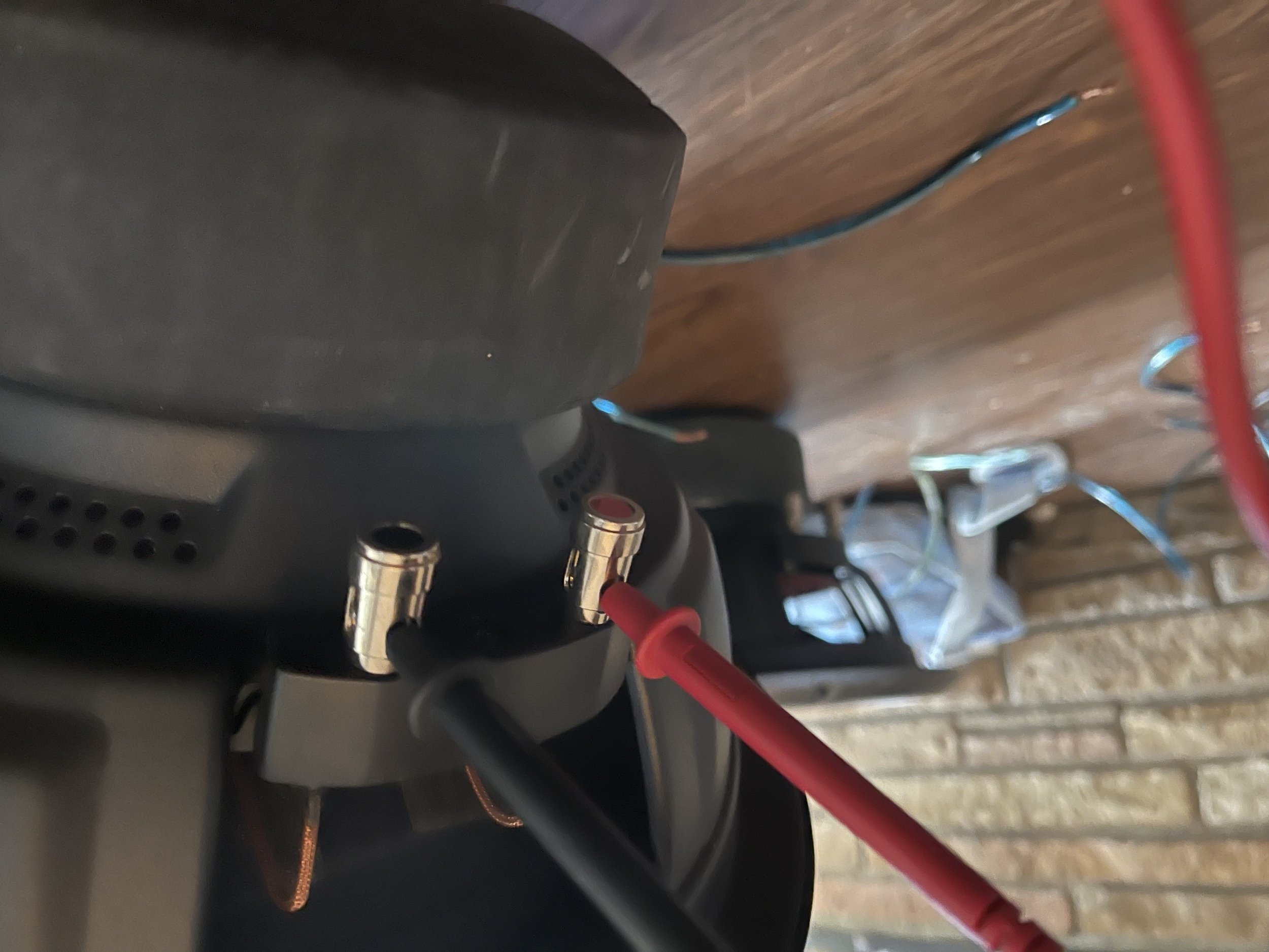

Are they used? Take a picture of the fluke with reading and settings and take a picture where your probes are. Do you have another multimeter to test

I tested all the same way just like this

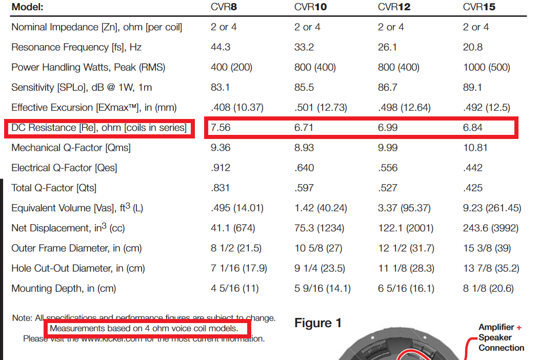

Yeah just to pile on with that, your reading the DC resistance, not AC impedance. DC resistance will vary from speaker model, but I don’t see anything to worry about here, it is often times lower that the rated impedance.
Edit: I remembered the old Kicker manuals stated the DC resistsance. You can see the specs are based on 4 ohm voice coils, since the subs are DVC they are wired in series for their measurements, and they show the DC resistance of each model.
