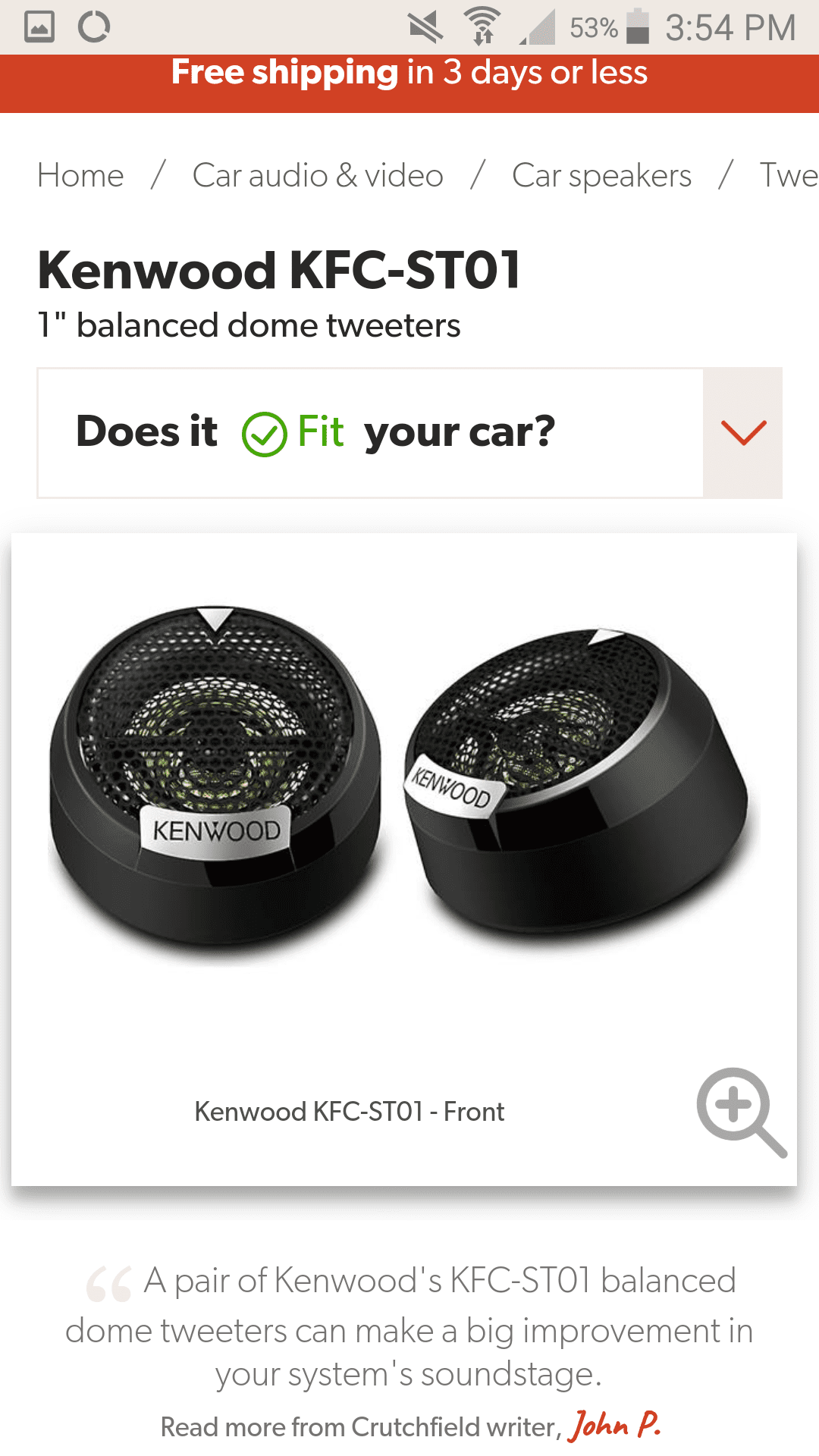

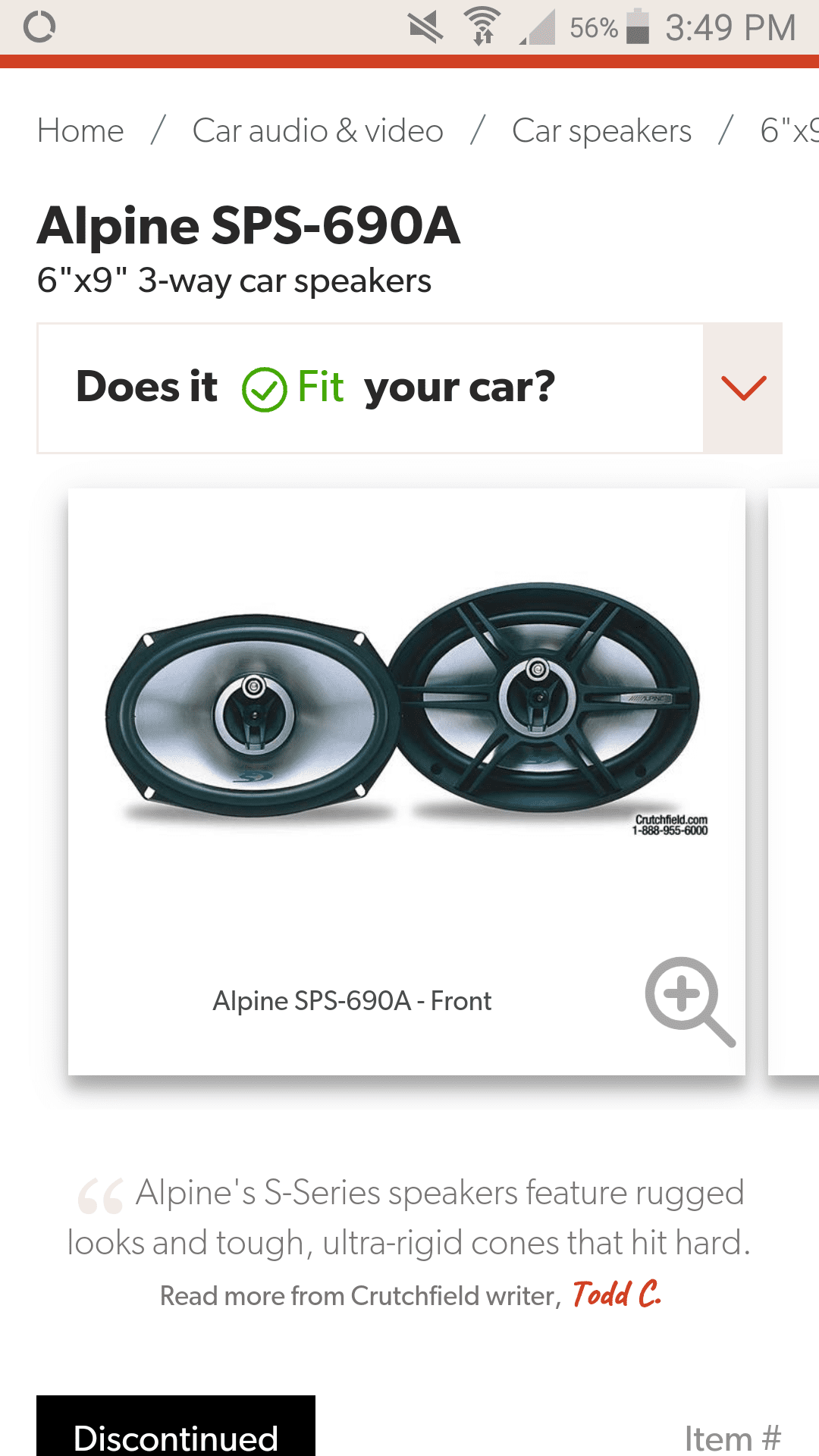

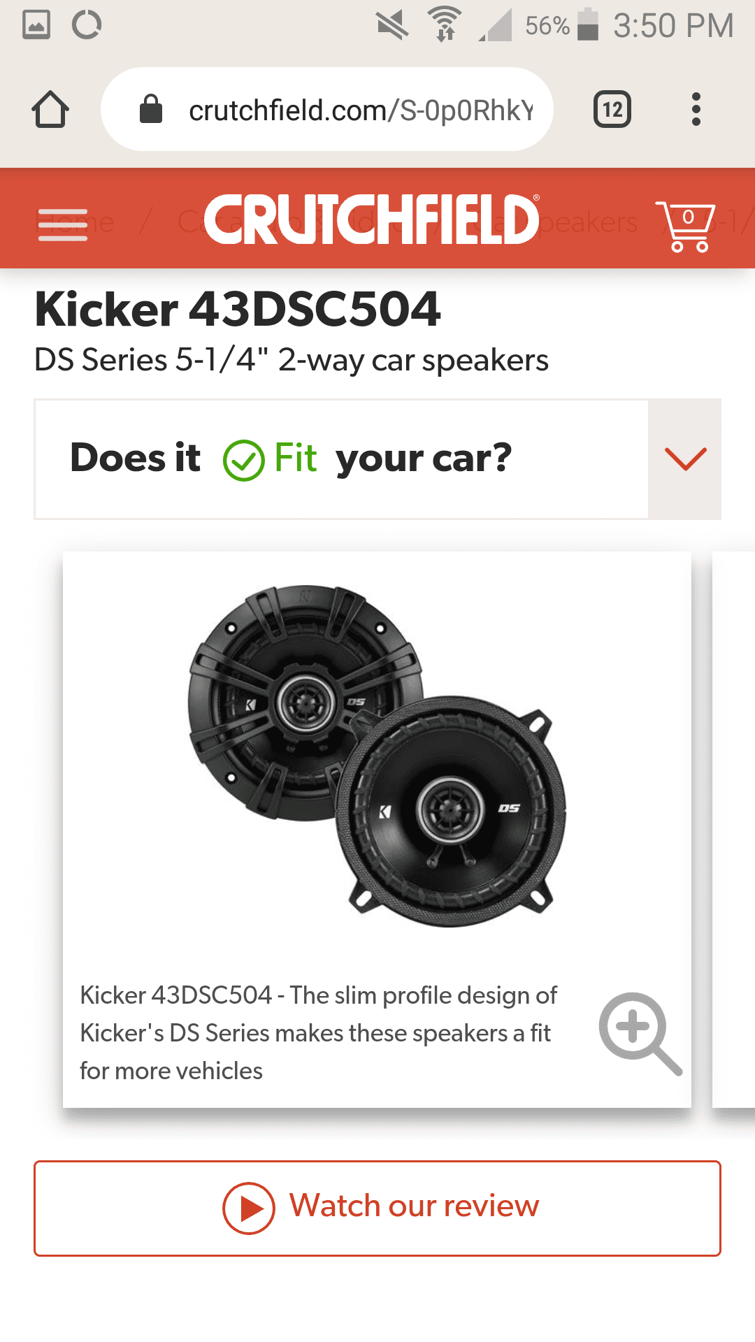

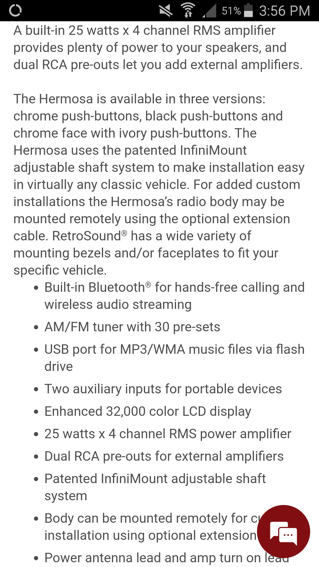

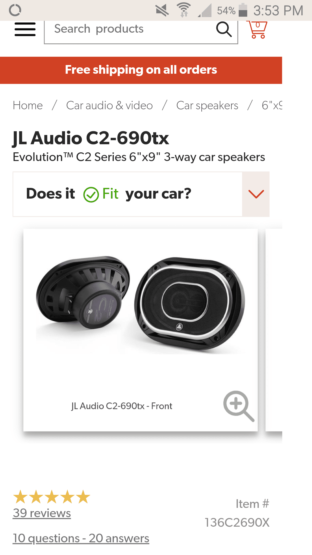

Alright I'm going to try this. These are what I have, the 2 subs that amp, and 2 of each of these speakers and the last one being the details on my deck
what would you put in, and wired to what, I would spend money on a different amp or speakers or whatever you think. Just keeping in mind I don't need anything crazy. But if I'm going to do all this work I kinda want a setup worth while
Or I'll buy another amp maybe a Kenwood xr601-1 and run both subs off that and 4 door speakers off the alpine. My questions are does that sound dumb, how would I connent my deck to them and would that cause a problem overloading my battery or something like that
You have dual rca preouts. Most simple solution is use One set for the subs and one set for the speakers. Separate mono amp for the subs and bridge the 4 channel to 2 channel mode. JL’s are probably the better of those speakers but a Component set with a passive crossover and the ability to position the tweeter high and midbass low would be better for your imaging.
Just so I'm getting this fully. I will run one set of rca's from my deck directly to a mono amp that will power my subs. Then what, why would I bridge my 4 to a 2. Could I not power all four door speakers off it. Probably the jls and just something else for now, then when I have more money I'll get a pair of good ones and replace whatever other ones I put in. Also would it sound horrible to run those Kenwood tweeters off the deck or should i just keep the tweeters out of it
BCotrell's suggestion of bridging the amp and running only the JL's is because those two are the best in your aresenal. Also those two will provide more than enough volume to your truck and be easier to wire. I think it a good idea to wire the tweeters directly from the radio onto the pillars for imaging. I would upgrade from 6 gauge to 4 gauge on the battery to amp wire. Everything else looks good.
