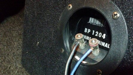

I hooked everything up putting in my amp and subs, but the subs dont make any sound. The subs do make a thump sound when completing the circuit but thats it. The green light shows on the amp showing power. I dont know what I did wrong but obviously something is.

Well for one you have your speaker wires into the Power and Ground wire terminals instead of putting them into the speaker wire terminals,lol.
Take the positive speaker wire and put it into the positive mono speaker terminal and then the negative speaker wire and put it into the mono negative speaker wire terminal.

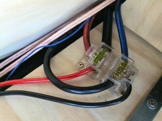

  • Firstly, buy a power distribution block and run each wires respectively to the nominated audio gear, as the install job poses a threat to you and your ride so do this ASAP, remember what Young MC said, ' got no money and you got no car so you got no woman and there you are!' - Bust a move - Young MC. :veryhapp:

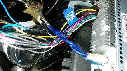

  • Once you have done that, check your head unit if it has a provision to run a subwoofer as it looks like only one pair of RCA is connected to the head unit.  If not sure about your head unit settings, take it to a car audio shop so they can check it out for you.
  • In most cases. you have to option of choosing Speaker / Subwoofer (yes/no) and then it may prompt you to select subwoofer frequency and loudness like, 0db, 3db, 6db and reverse db as well.

  • If your head unit issue with subwoofer controls are all good and the subwoofer is ok, then also check the RCA cables.  Run another pair to the amp to see if it works.  Faulty RCA's do tend to pose a nightmare as they do fail over time.

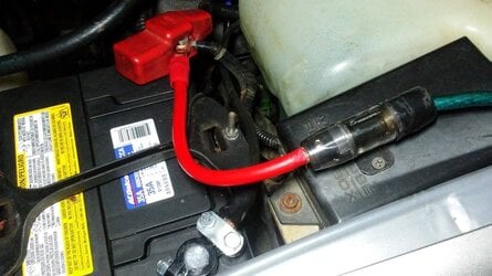

Besides wiring the subs to the power/ground.....are those two 30A fuses and a 2A in the amp?? How long are those drywall screws that you used to secure the external fuse into the factory fuse box? I'm really hoping you didn't use anything over an inch....
If this is a real post, please stop what you are doing. Disconnect your amp to prevent further damage to your vehicle and system. Please, for the love of god, take this to a reputable shop to have it professionally installed.
EDIT: I just realized it's supposed to have two 30's and 1 2A. I am guessing the 2A is for the illumination since this is the "illuminite" series of Dual amps? I thought that was the high level ouput next to the fuses but apparently that is for running running the external lights.....high level is on the opposite end. Well, I take back my ill thoughts towards the OP because I thought he used different sized fuses because he didn't know any better lol.

Well I looked over all the comments and corrected the speaker wire location attached to the subs that were in the ground and power slots on the amp, to the + and - on the bridge and its all working. I tested for any drain on the battery and its good.
I had the small screws that came with the fuse holder but I lost those so I used the screws in the pic which are only slightly longer, but doesnt touch anything. The fuse box was the only place where nothing would get in the way.
