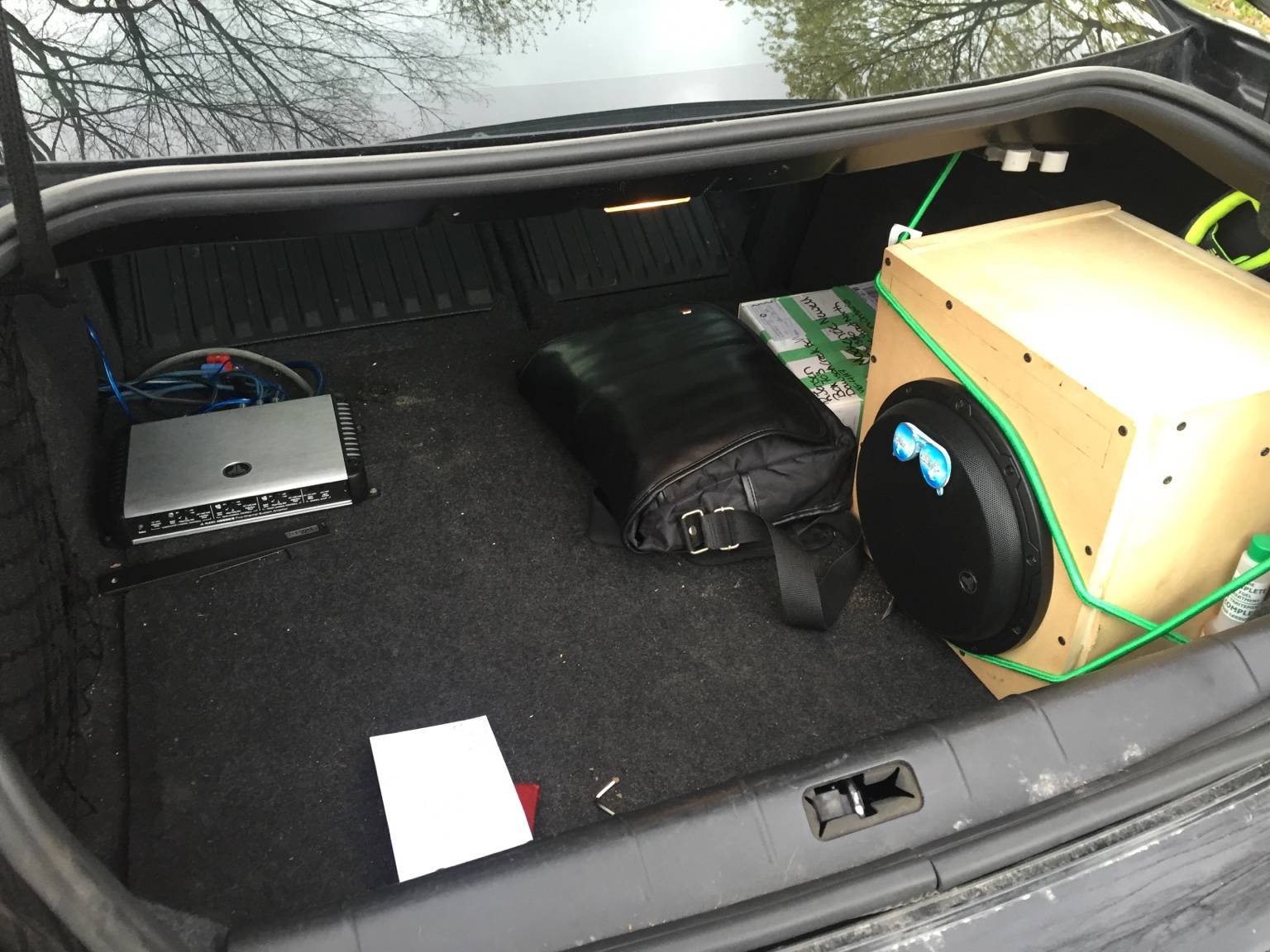

Wait so why are you not running your speakers active with the 80prs? It seems like you spent a lot of money on JL products where you could have purchased a lot more for your money. My 05 RE XXX, $350. BNIB FSD 1600D & 85.4,
$450 for sub, $400 for amp. The Silver Flutes & Seas Neo H1396's sound better than any component set I've ever had, ran active, time alignment, properly deadened doors.
Let's say you went with my $150 speakers to go active, then you have a bunch left over to buy real sound deadener, keep your subwoofer and amp if you want but I think you will see a huge benefit from switching to raw speakers using your great head unit you purchased as the crossover to its potential! That's what it's made for!
Have you heard CDT's? No offence man but you get what you pay for with many products, I'll admit JL is a little on the pricy side, but there HD amps are very very good. And again if we are throwing around opinions, then the HD amps are the best class D amps... But that's my opinion. But many other people's as well. Also CDT make amazing speakers. So does seas but $150 dollar speakers better then $650? I doubt that. Plus I got mine for $250 CDN of a guy so I count that as a win... Also I'm not running active cause I'm running rears and until I feel like buying another amp, I'm not going to be an idiot and run tweeters on 2 channels and then my rears and woofers on the rear channels starving my speakers of power by running 2 ohms and only getting 37.5 watts per woofer. But 100 watts too my tweeters. Idk if that makes sense to someone please comment! Also JL w6v3 over RE XXX any day, but again that's my opinion.
So in the end I guess we just have different opinions.

Have you ever done any critical listening? Are your ears trained?
If SQ is your goal, yes active. If you don't have processing for the rears, lose them.
Sheffield labs test cd
Cheesky ultimate demo cd
Get them and test your setup. Be real with what you are hearing.
ditch powering the rears, without proper tuning it's probably messing up your staging. Go active on the fronts, I was in your shoes and didn't think active was worth it or that it was hard. Let me tell you it really isn't, and the improvement in transparency, staging, clarity is so improved. You're losing a small amount of power going through those crossovers too.
Do some research, you should find a lot of info about active vs passive.
I have spent time tuning, but I also have tears for my passengers. And yes I travel a lot with friends and family.
I want to go active, no argument there, and I will do it. I don't think it's hard, it's just more amps. But my plan in the future is to get, a bit ten, ms-8 or a arc ps8 proccessor, and a HD 600/4 or another 900/5 and then run active. Run rear fillers, and the 900 would be if I want to re ad my second w6.
But I'm going to address the title. It's a "practical sq build" so I want my passengers to enjoy music, as well as have trunk space. And so I'm taking steps to getting there i.e. Running passive... For now. Slowly building.
I thank you for your input and suggestions tho! And I will try to speed up the process, because I will honestly say, even tho it sounds good, ik it can improve.
Have you ever been to a concert that has speakers behind you?
Similar to what we are saying, the music should be coming from the front. Your passengers will have no problem hearing the music. Use the rear speakers off HU, run the front active. That way you're still adding to the overall sound but the real staging is coming from where it should, in front of you. Something to marinate on, it's your choice obviously but you should look into it and think about it. We aren't just blurting BS. System looks good besides those small things.
