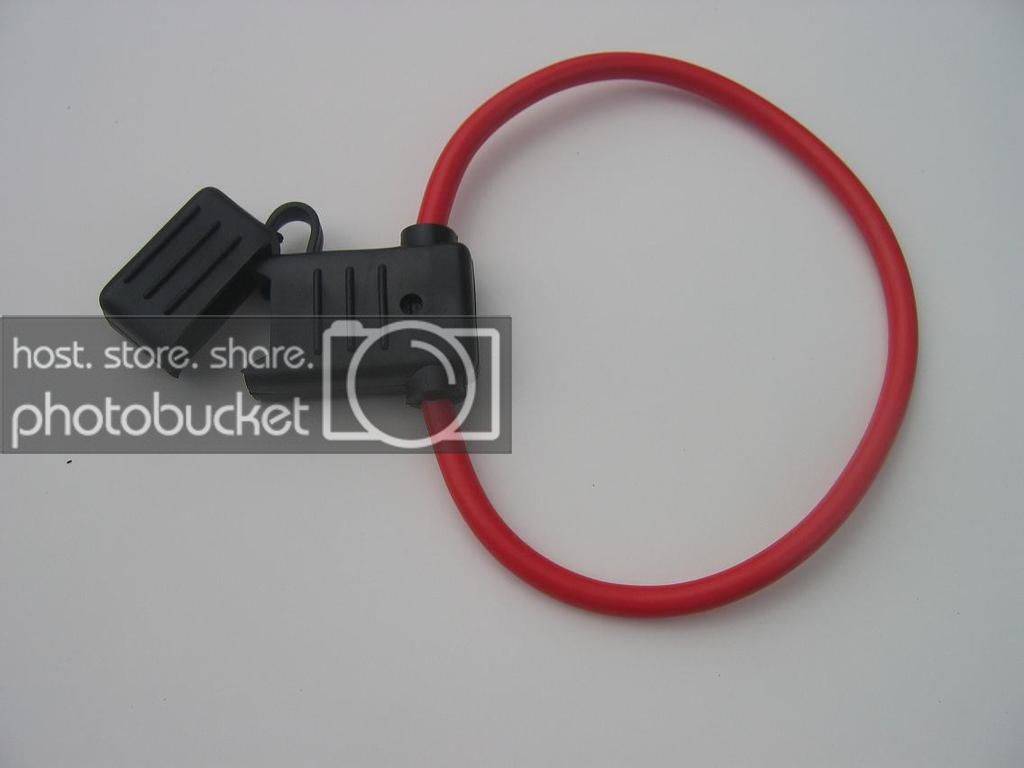

Thank you. I think I will follow your suggestion. I have some extra 8 gauge wire, terminal ends and a fuse holder. My fuse holder looks like 10 gauge wire and is a blade style with a cap. This is what I used in my Rondo - one line for amp and one line for subwoofer - and it's worked fine. Each power line in my Rondo uses the inline fuse holder as shown in pic, each with 30 amp fuse.

Yup you need dedicated runs of wire. Doesnt matter what the calculator says. Your amp is getting warm, its going into protect ALONG with all the symptoms improving when you redid your ground. This is all pointing to the amp being starved for current due to a weak power line. Issues and problems arising speak for themselves.
