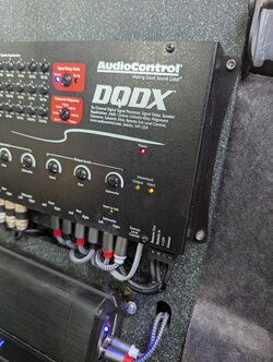

I'm having a problem where every once in a while I get no audio upon starting my car. If I restart it then I'll have audio. Audio never cuts out while driving. I got stuck while troubleshooting, so heres my current situation:
My setup is as follows.
Pioneer head unit > Audiocontrol DQDX > 5 Channel amp > All speakers and subs
Everything is lit up and powered on when this happens, so loss of power is not the problem.
I figured an easy way to rule out the head unit was to wait for the problem to occur and then turn the input gain up on the DQDX and see if I can get the Maximized Input light to come on, which would tell me if my head unit is sending a signal or not.
The problem is that I got the opposite of what I wanted to see: the Maximized Input light is actually solid orange no matter how much I turn the input gain down. (When the audio is working fine, this light stays green until I turn the head unit to max, when it then starts flickering orange.)
I cant find anything about a solid orange input light on the DQDX. Hoping someone here knows more about this kind of setup than I do. Thanks in advance.
You can acquire a 3.5mm to RCA cable and plug it in the DQDX and your phone. When the issue occurs play music from your phone. If it plays then the radio is the issue. If it does not play then plug the cable to the amp.
Those cables have been so beneficial in setting up and troubleshooting so many systems, the inventor deserves a trophy.
Great idea! I'll leave one in the car and try that out next time it happens.
So it finally happened again and I was able to use this method to troubleshoot. Looks like its the DSP.
I guess I'll just be dealing with it until I feel like buying a new one, unless someone here knows what the issue is and/or a repair.

Dirty potentiometers and switches may cause sporadic loss of signal; with the system off do full sweeps of the gain knobs and cycle any slide switches several times. No need to sweep the frequency pots, those would only affect their alloted frequency.
Gotcha. I figured opening it up and poking around may be worth it? I'm pretty handy but this is a somewhat expensive piece of equipment so I'm not sure if its worth the risk as it still works 90% of the time. I'll start with the sweeps and go from there. Thanks!
It being solid state components I doubt it would be something easily visible like an amp's bloated capacitors or burned transistors.
Speaking of that, another test is to wiggle the RCAs. Since those stick out it is easy to bump them and causing potential issues. I have fixed broken solder joints on the RCAs of a few amps.
Yes, it looks pricey. I would not mess with it too much if these simple test do not yield results. There are guys on eBay that fix EQ/DSPs. May be worth a looksie.
