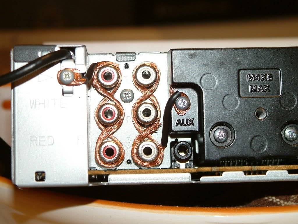

Another thing you can do is to ground your Head unit RCA.
strip a 4-5" section of wire, wrap one end around the exposed part of 1 rca and attach the other end of it to the headunit case via a screw on the case, you should be able to access a few.
