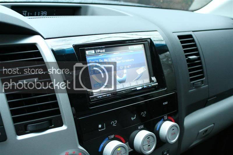

it will look like this

Keep_Hope_Alive, thanks so much for the photo. That helps SO MUCH. Also, great beard.
