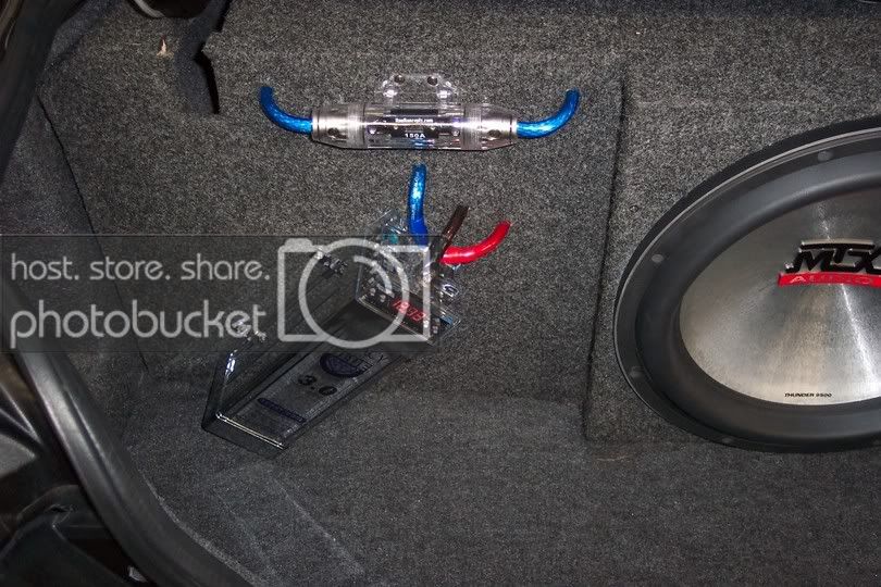

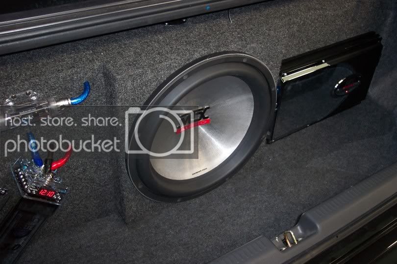

New here & just showing my setup //content.invisioncic.com/y282845/emoticons/biggrin.gif.d71a5d36fcbab170f2364c9f2e3946cb.gif I did all this setup & builded myself.
I know caps **** by it just for show hehe

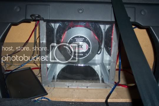

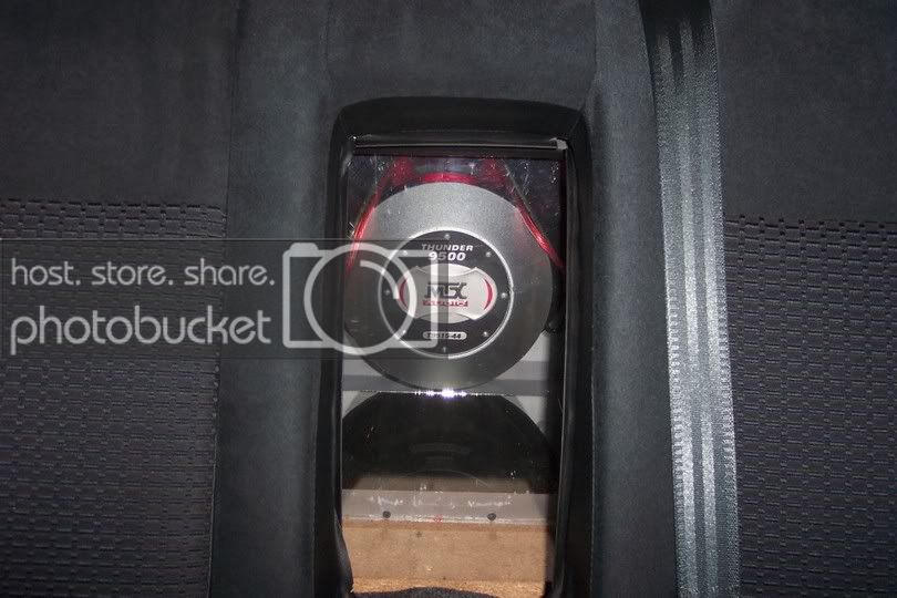

Back view yes it's messy but the seat is down
with seat up
Im gonna change the whole setup to ported box. Nobody hasnt answer my question yet which right here http://www.caraudio.com/forum/showthread.php?t=160459 //content.invisioncic.com/y282845/emoticons/crap.gif.7f4dd41e3e9b23fbd170a1ee6f65cecc.gif

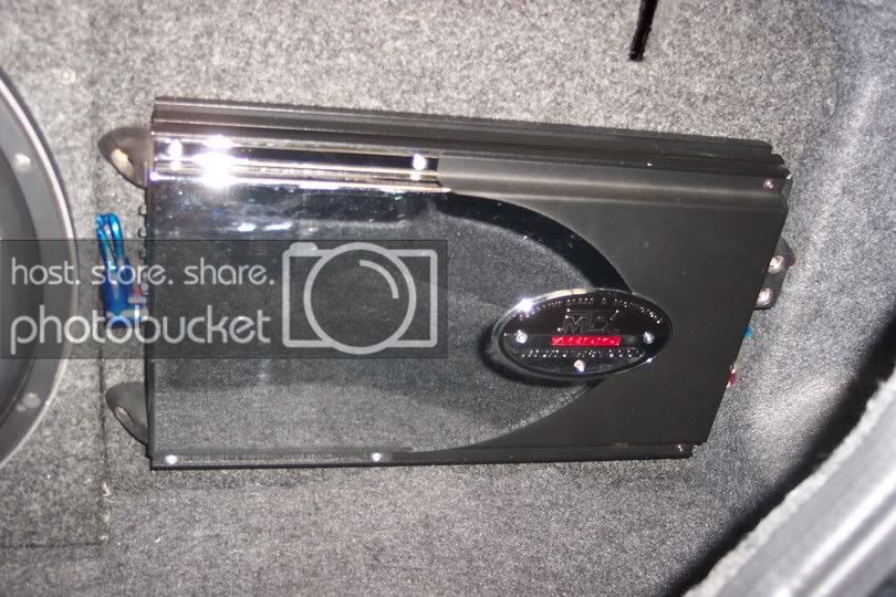

nice lookin install the amp is //content.invisioncic.com/y282845/emoticons/yumyum.gif.0556df42231b304b9c995aefd13928a8.gif//content.invisioncic.com/y282845/emoticons/biggrin.gif.d71a5d36fcbab170f2364c9f2e3946cb.gif
The cap isn't completly useless considering it tells you the voltage =). Thumbs up on the install, and do you have a secondary battery? I hope so because your fuse MUST be within 18 inches of your battery.
lol yea, i have 2 fuse actually. one is under the hood by the batt to cap then fuse to amp. just in case if cap blows up, then batt & amp would be safe. haha
it's like this: yellow top-wires-fuse-wires-cap-wires-fuse-wires-amp. im just precautious lol
nothing wrong with over fusing.
im not sure what size box the 9500 would like ported, i would look under manufacturer recomendations and then figure it out. id prolly tune it to the mid 30's tho. i would try ~3 cubes @ 35hz first and go from there. and you most likely are going to have to pay somone 5~10 to design you a ported box, its really not hard, but its not something i enjoy doing for kicks.
