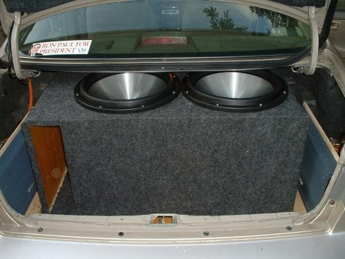

The box I posted pics of worked well. If you angle the top it will allow you quite a bit more volume. Be sure to NOT block off the hole between the trunk and the cabin, the more space you can leave around that for soundwaves to pass through the better. I had pretty good results subs facing forward or back (with back seeming to favor lower notes in its response). Most of the boxes I made I had ports and subs on opposite sides.
This one was OK, tuned very low and I think I lost a bit of output from it being too **** big and blocking off the hole:
How many amps is your alt and how much was it? I guess since I'm going big I might as well fire forward and seal the trunk. I had 2 10s sealed a while ago and it is very true, the lows are better with the subs firing backwards.
