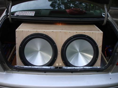

I should preface that by saying I was tuned to @ 28hz. I was using a 5.1 surround HU and I wanted low tuning for movies.
Same box with a pair of 12" LMS 4000's but subs firing forward
These delivered more output
If the car was still on the road and I wanted to get loud I'd definitely seal off the trunk and mount to that hole there where loud might happen (at the expense of low extension) This box firing to the rear gave me much more low freq than facing forward.
