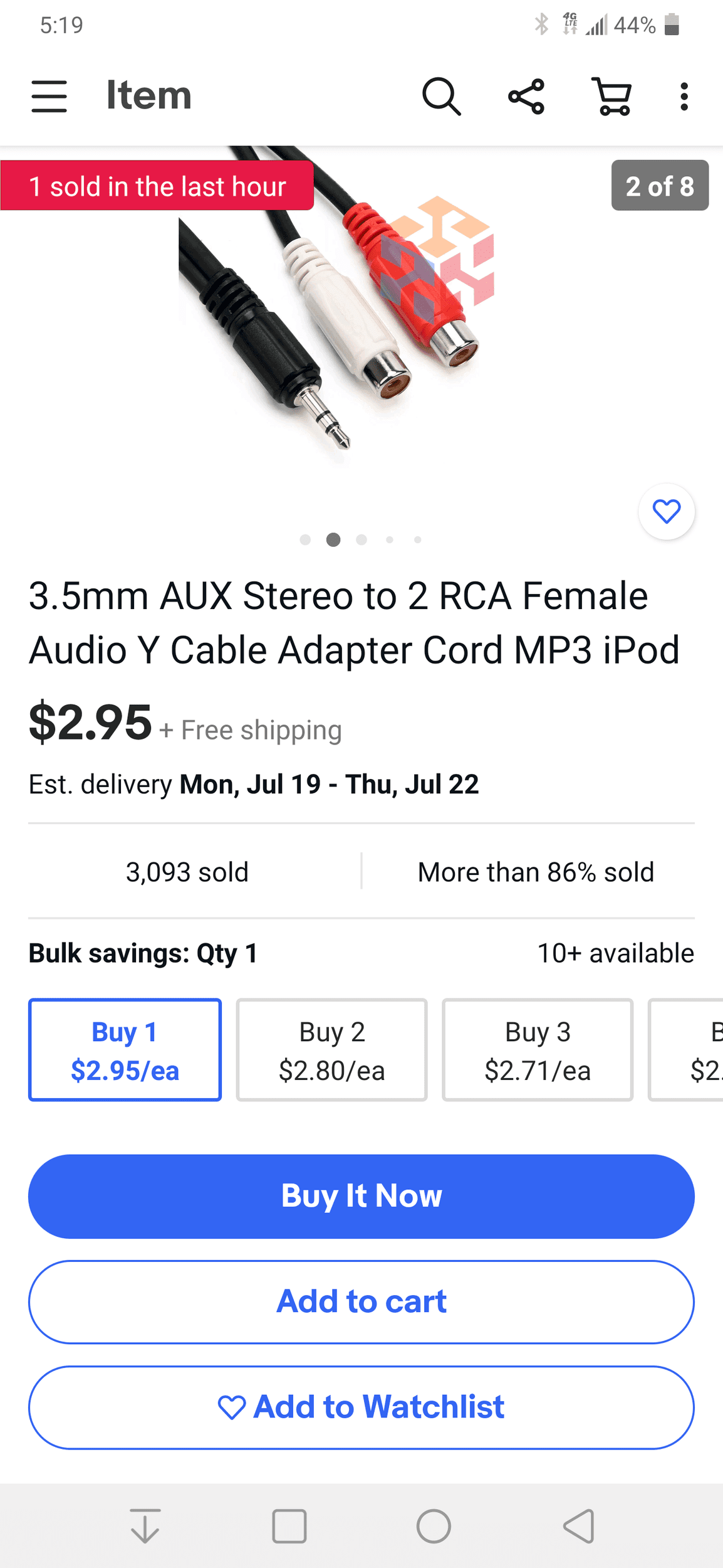

Try connecting a 3.5mm to RCA cable from your phone to the amp. This will hopefully rule out the amp. Better yet, you could use a 3.5mm to Female RCA adapter to test the RCA cables along with the amp.
