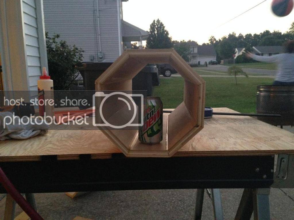

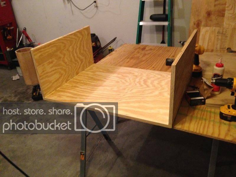

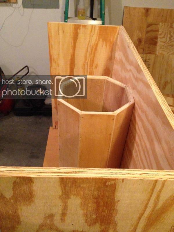

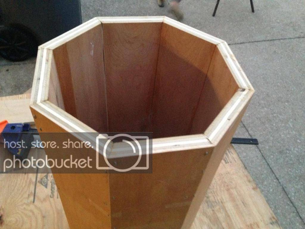

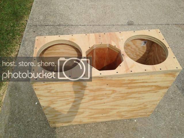

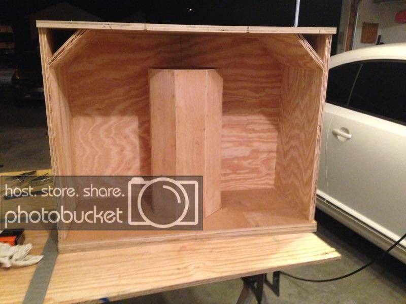

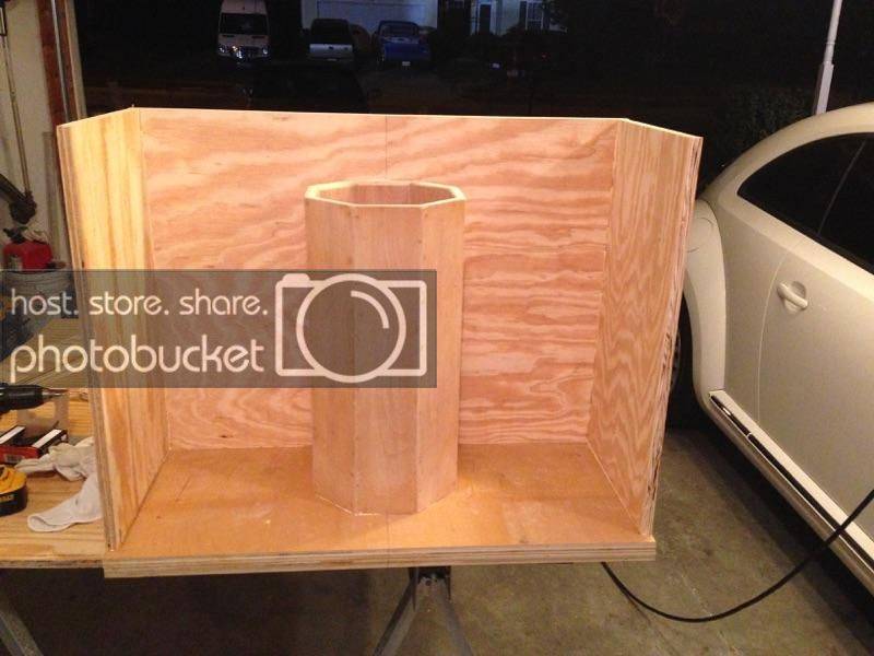

New hdc4 12s box ..with octo!!
NASTY08IMPALA
[uR=http://s1315.photobucket.com/user/NASTY08IMPALA/media/Mobile%20Uploads/IMG959460_zpsutsyuv25.jpg.html]
[/url]URL=http://s1315.photobucket.com/user/NASTY08IMPALA/media/Mobile%20Uploads/IMG958823_zpst8nujlrl.jpg.html]
[/url]
---------- Post added at 09:55 AM ---------- Previous post was at 09:54 AM ----------

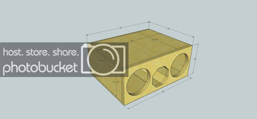

Box is 4.5 cubes at 36htz with a 8 11/16" octo
What is the advantage of Octo over aero?
Well a octo doesnt cost 100 bucks lol and looks better . Yes more efficient than a slot port and can use less port area ..nit that i did. .this will still do hair tricks

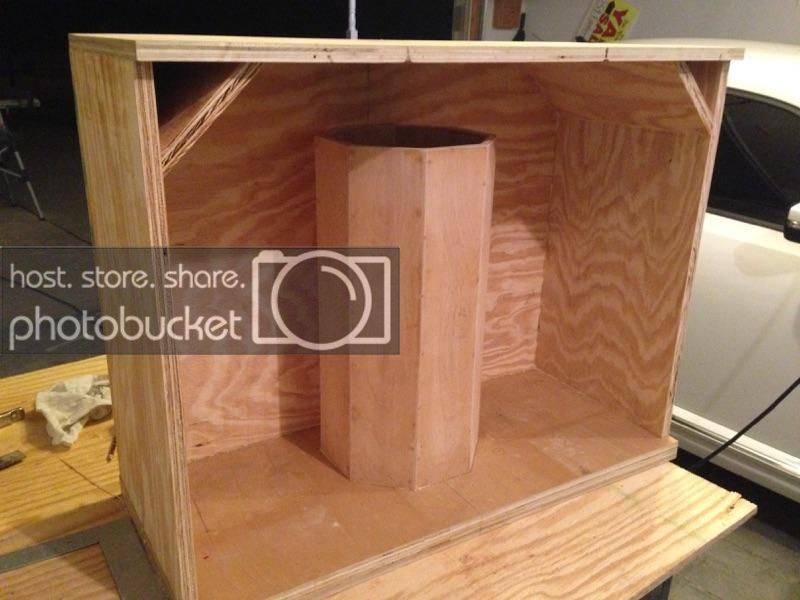

More pics to come as box comes together..just wanted a teaser with the octo

Port is arauco and box is pine for anyone wondering
