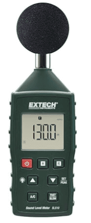

What type of meter are you using to measure decibels?
Extech SL510
And
Iphone
They were 107 and 110 consistently.
I figured the iPhone was generic so I got the meter from a friend. Only read three decibels higher
Extech SL510
And
Iphone
I believe that meter is useless for car audio, a useful tool for an Osha inspection in the workplace to determine compliance and hearing protection levels. Use better tools and expect like 138db+ min from your setup minimum imo.
Extech SL510

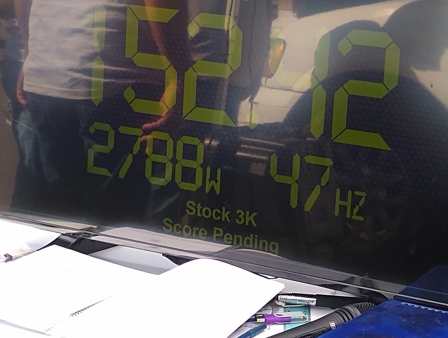

I MIGHT have hit 128db with my last setup using a meter like that.
But my competitions yielded higher results and Termlab/Magnum is brutal...
Using a phone or osha meter is way off base, Even a mini meter is a HUGE improvement accuracy wise.
Post results once measurements are legit
And make sure it’s on the right settings. I forget the exact setting, but a lot of these style SPL meters have a filter for different frequency testing. You want C weighted setting if I recall, and make sure you are playing bass in the meters range, looks like 31.5 HZ to 8KHZ is what that one will measure.
I have an old Radio Shack SPL meter, goes up to like 130 DB and my single 15” will peg it in the corner with bass testing. I’m not saying my 15 is crazy loud, it’s not, rather it is fairly easy to hit the 130 DB mark in a car. My old Kicker CVR12’s could easily peg it as well.
Haven’t messed with a phone APP SPL meter in over a decade, they did not work right with the phone microphone and such so gave up on those a long time ago.
Other than that, as was stated could be low input signal, hard to say without going over it / measuring, but a pair of P3 12’s should be able to get fairly loud.
