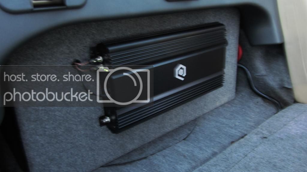

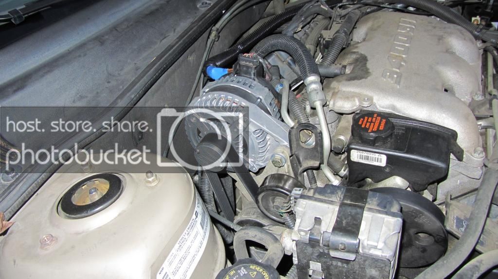

Ran into a snag with the 320 alt had to run a thru bolt and a nut. Looking at Monday evening for picking up the car. Phone took a crap on me so haven't gotten any pics. Sound Qubed Q1-2200D was so big it's got it's own side of the board lol. When you drop the back seats she's sitting horizontal on grey carpet with all the wires tucked thru holes to the back of the board looks nice. The Kenwood Excelon was delegated to the back of the board along with the power and ground distros and the wiring.

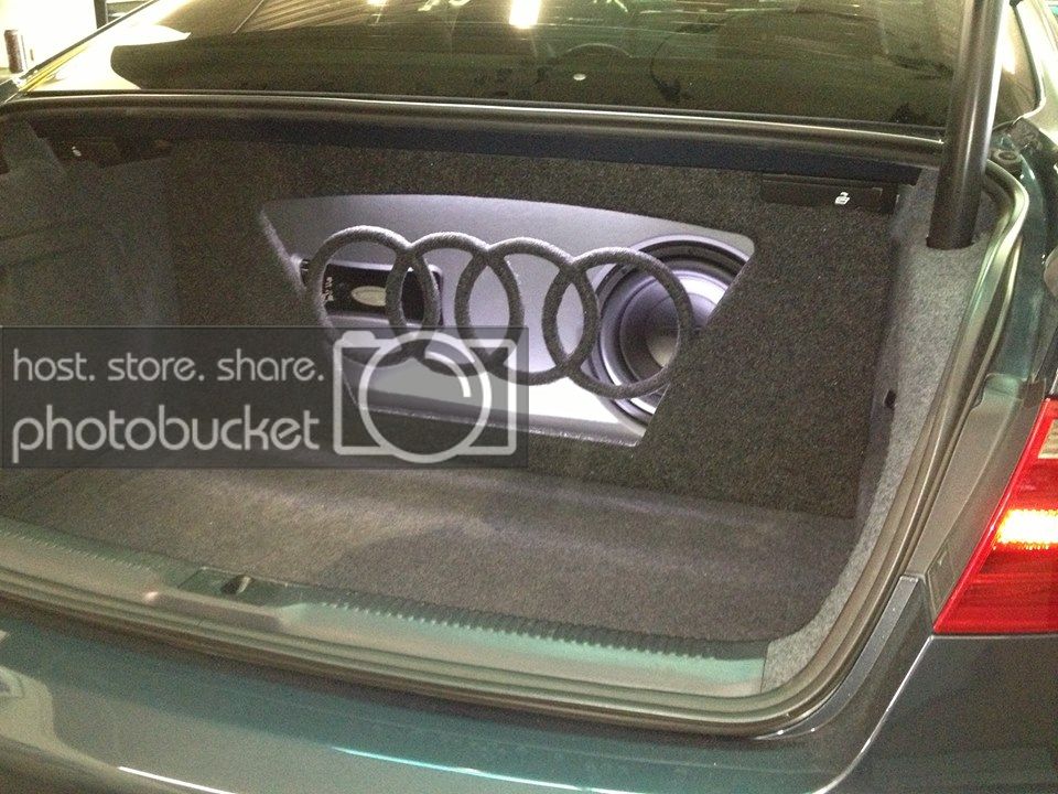

Well got everything installed and up and running. Had to cheat a little and run the wall a different way. Actually more of a box in a box to be honest. Box is wrapped in black velvet. All the wires and stuff are on a board Sound Qubed Q1-2200D is all alone other amp and distros and stuff on back of board. You can see the battery box on the left. Singer 320 FTW :

Guys did a great install imho. The company is Rolling Audio in Roseville, CA. I was pretty involved and made several trips while he had the car to make sure we were on the same page. Took a little over a week to finish basically due to roadbumps like the alt needing to be fit. I had to wait on Michael before messing with it to make sure it wouldn't void the warranty. He was super big //content.invisioncic.com/y282845/emoticons/thumbsup.gif.3287b36ca96645a13a43aff531f37f02.gif for Singer Alts. I ended up not using the battery terminals I had gotten and went with the Standard M6 screw and rings on the 2nd battery.
Is it sealed or bandpass? Doesn't look like much room around the box for sound to get into the cabin. Also, is there anything under the amp's mounting feet to reduce vibration transfer?
