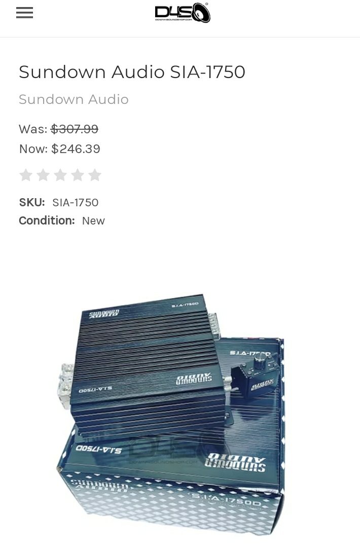

If you buy a new amp take a look at this one also. I'm sure that the soundcubed is nice to.
