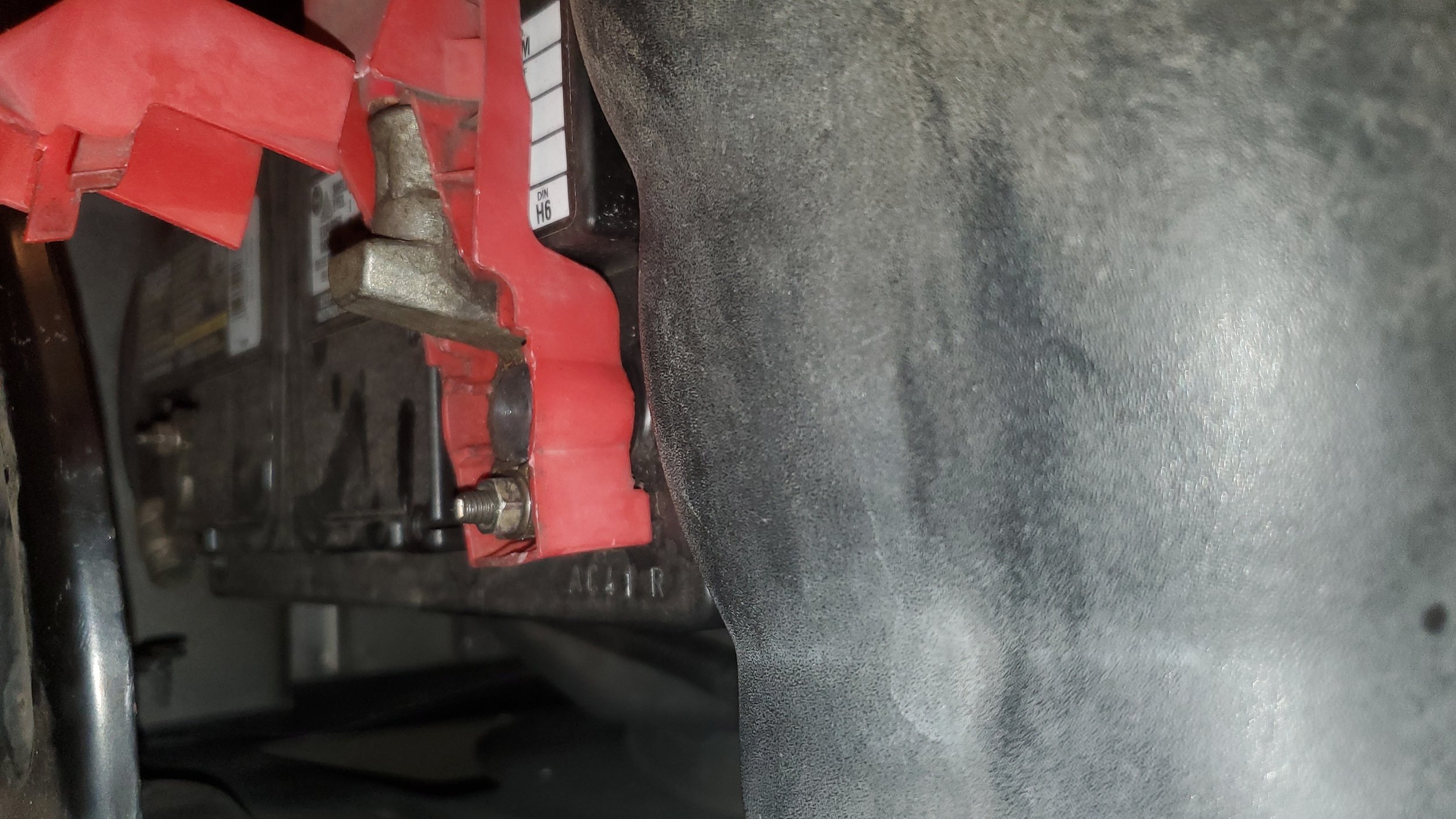

I think my problem starts here. My last system was so weak that i assumed since it was using 0 ga that i was good to just upgrade but i think that isn't the case. The 0ga power was just attached to the small stud with a ring terminal. And no added 0ga ran from neg to chassis.

You can get bigger battery terminals that have more bolt-on places for wires.
