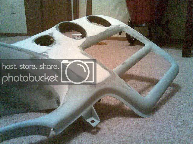

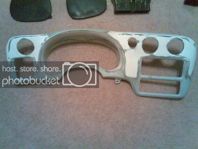

here is some pics of what i have been working on so i can get started on my door panels and stuff:
put grand am eyeball vents in the dash... looks different and fucitons the same.... should look pretty good covered in black suede

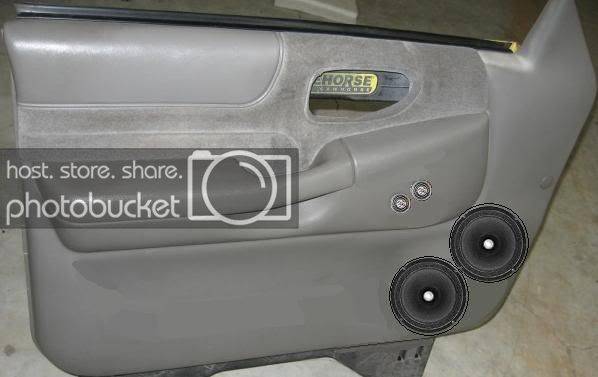

but i am using spandex fabric and using ca to attach it to the door first then using resin on that so make the general layout..... then using woven fiberglass cloth on the back side for strength and to attach it to the door panel even more!
i will be using 8" PVC pipe attached to the door itself and the mids will be attached to the pipe, not the door panel. i am afraid the door panel fiberglass won't hold an extra 16 lbs long at 150+ db...........
but i am hoping i should be able to mold the panel around where the 8's will sit on the door....

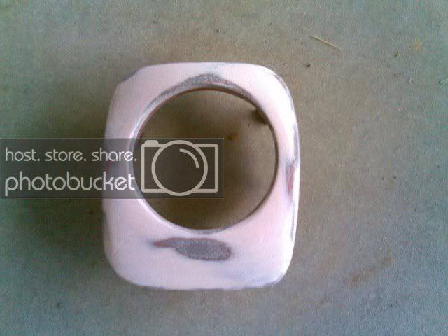

here is some pics of the mids and tweets:
and a pic of what the doors should look like when done:
