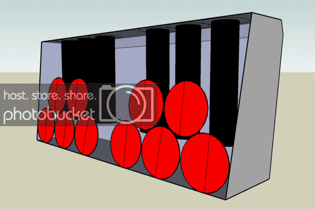

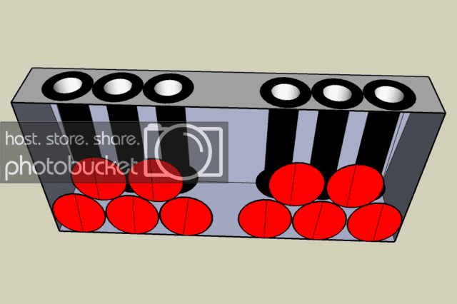

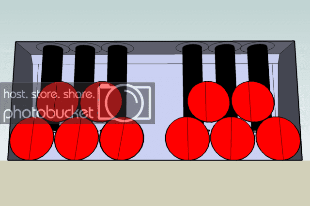

Here is some pics of what the box should look like:
the box measurements on the outside are:
24" tall
12" deep bottom
9.25" deep top
54" long bottom
57" long top
odd shaped i know but it fits the cab.... and i will be using 1/2" MDF on the bottom and back of the box to get alittle extra room! if you want you can fingure out how much air space i have. if i remember right it's close to 7 cubes total... in a std cab truck box.... LOL

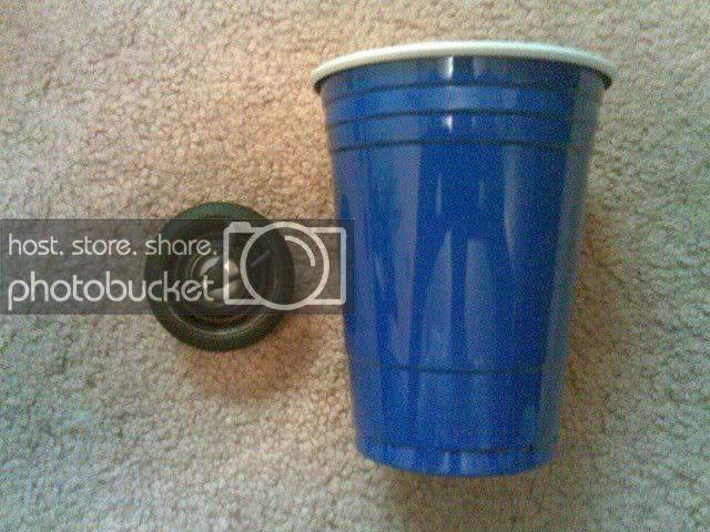

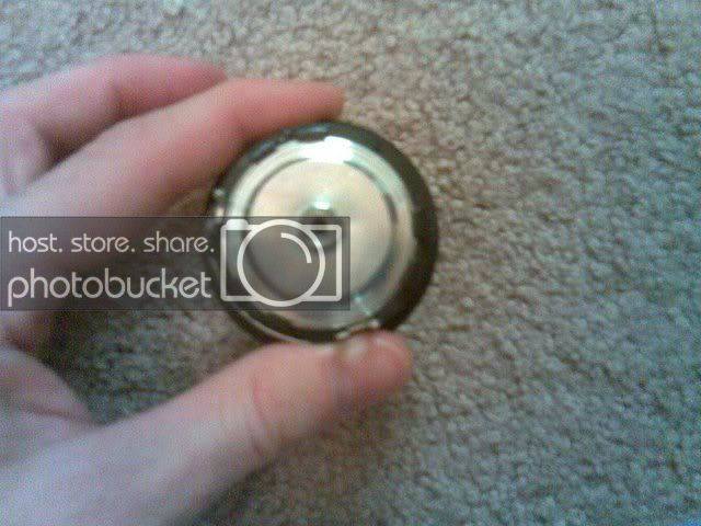

here is some pics of the mids and tweets:
