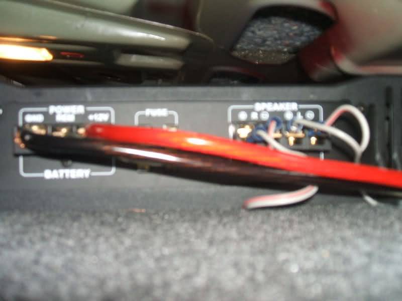

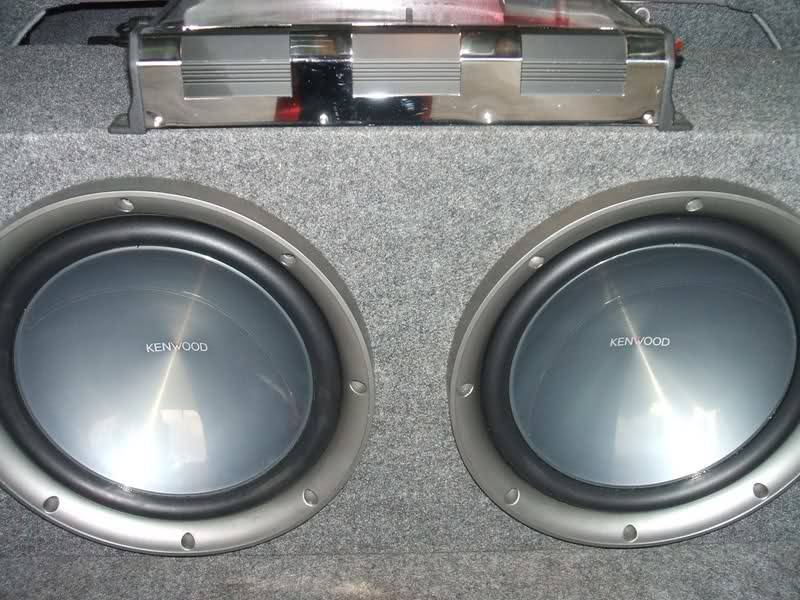

do you like the way your subs sound? no need to replace it if it sounds good to you. the one thing i would do is to upgrade to larger speaker wire from the amp to the subs, that stuff in your pic looks kinda cheap.
also, i don't think you'll be able to run all your door speakers off that insignia amp because it looks to only be a 2-channel amp. meaning it should only run 1/2 speakers. you can run run 4 speakers from a 2-chanel amp, but you have to make sure the amp (and speakers for that matter) will run at the ohm load created by hooking up 2 speakers per channel.
I would get a 4-channel amp to run your 4 door speakers. the clarity and power will be much better coming from an amp then from the HU itself.
