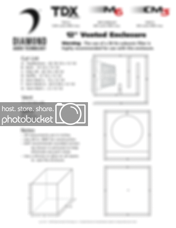

thanks for all the help moe! i just got an email from Diamond Audio...this is their box design for the 12" TDX...its pretty odd looking
The diagram for the box is pretty common, but its entirely for SPL, you might look into a different design if you wanted anything else.
Isnt the diagram for the box you just posted way too big ? You original post said something
about being limited to around 1.4735 cubes ?
correct me if im wrong but isnt 40hz a lil extreme? O_O
40hz is too much for daily driving..
i'd pay Jmac to design you a box, its only 12$ and you'll get a nice diagram for your box!
goodluck
Moe Lester already drew me up a spiffy design for my box, i was just posting what DA sent me cuz i thought it was a little...out there. so you think the box DA sent me is too extreme for daily driven? the guy on the phone at DA said its "perfect for the subs"
yeah its way too extreme for daily driving, because the only 40hz notes that are played are in test tones, not regular music. Which would make it purely for competition and SPL. If you played regular music with that box, you would eventualy damage the sub.
