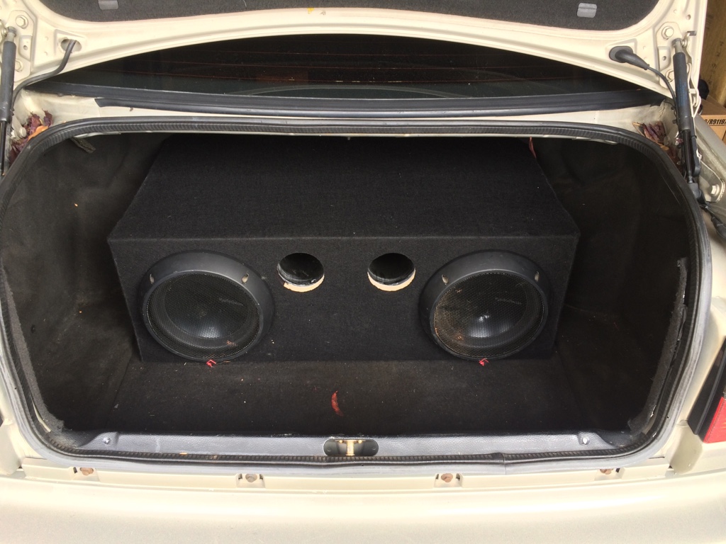

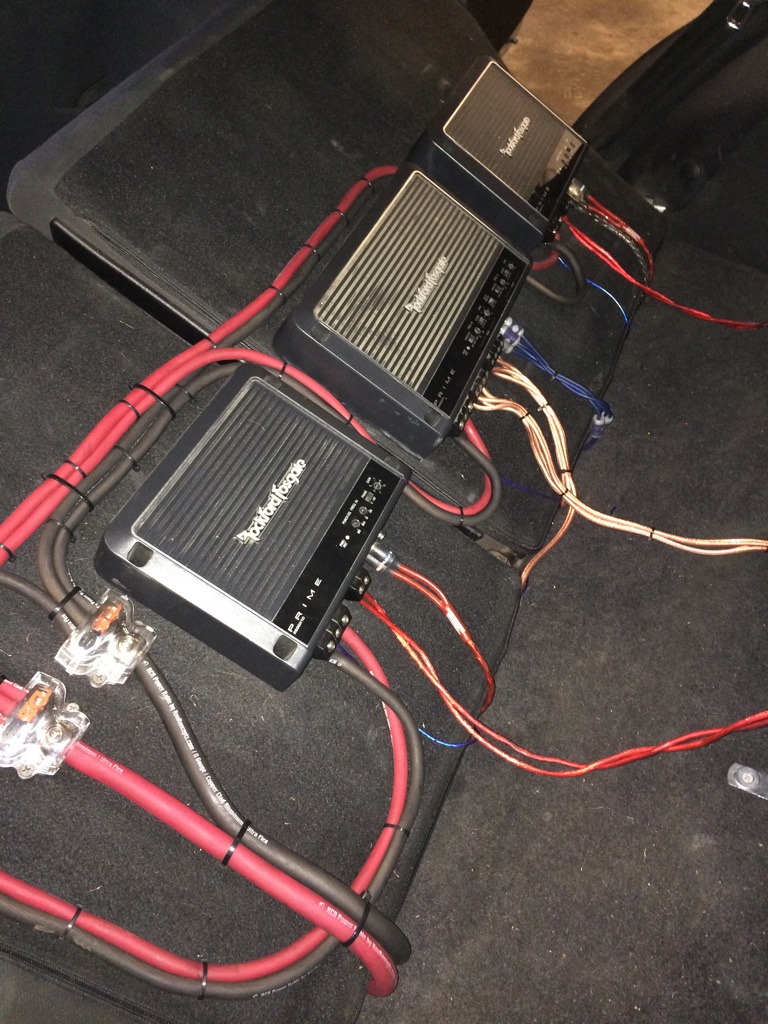

I have 2 Rocksford t1d410's powered by 2 Rocksford r500x1d's and it's just not enough bass. I'm still rocking the stock 90amp alternator and an interstate battery. Curious if an alternator or a battery will provide a louder more face melting bass or if it's just gona help with light dimming ect.. If I can't get more output with what I have or if I should just getting bigger subs?
Sorry for double post but I forgot pics
adding a h/o alt is not going to help, unless your lights ( voltage it dipping bad.
if thats a prepab box then build one for them subs.
that would be first.
if you want more bass you need subs that can handle more power and a good amp to move them.
but doing that you may need a bigger alt, and a extra battery in back.
how much money do you have for an upgrade ?
It's a custom box tuned for the subs. Voltage dips from 13.8v idle to 12v at full tilt. I'd like to stay under $1000 on subs. I like the hifonics amps so I may get the 3016.1d I think it is.

I leave my seat down with subs facing back. Would it help to aim them in the cabin?
---------- Post added at 07:31 PM ---------- Previous post was at 07:31 PM ----------
Hifonics is poopy. And only face then forward if you seal them off 100% from the trunk
