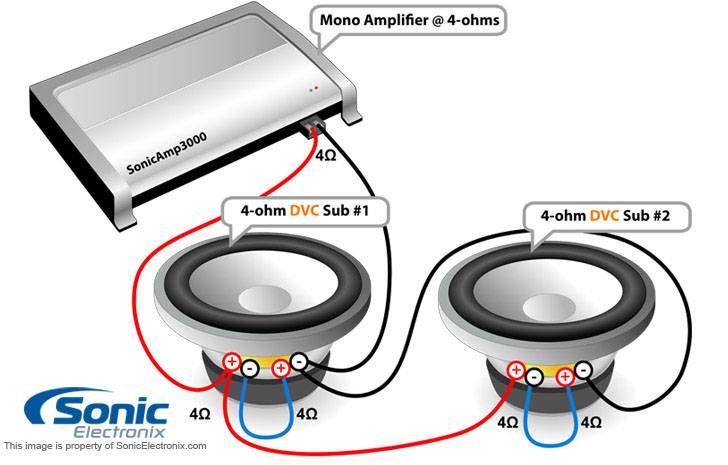

Need Help Wiring Two 4 Ohm subs

I'd listen to someone who would say that... I really don't know the skinny about things like that... otherwise just find a 1 ohm stable amp and parallel everything to give it a 1 ohm load...
Think I'm gonna go with that ppi 1000 when I buy one. Thanks for all the help guys! This helped me a ton, just one last confirmation, I can run my subs to my amp with that initial wiring diagram I posted? Thanks!!
if it's 1 ohm stable i didn't see that listed just that it does power at 2 ohm if it says 1 ohm stable then yes if not go back and read my 2nd post
So you are saying like this? I'm sorry but I cannot translate words into the wiring haha I rely on these pics! Also I know my amp is mono but there are two places to wire up your subs, I guess it's just one channel split to two contact points. My last question is going to be kind of complicated for me to explain. My box has two terminal cups, can i just run two seperate leads to the amp and then put both on the same connectors? I don't have enough wire to connect them inside the sub haha
well i would use both sets of terminals on box and amp so in that pic where wires are going to amp they'd be going to box terminal just in pic they wired subs together (and u can do it just like that and just use 1 terminal on box and amp, my way would be not to wire the 2 subs together so where the sub on right black and red wires go to other sub they would just go to the box and u run + &- on amp to each box terminal (using both terminals on box and amp)

this is what I want to do. Of course there are terminal cups that the wires have to go through EDIT: seems I don't know how to upload photos lol I am new to forums as well
Another edit: lets see if this one works also since I have two positive and negative ports on my amp i'd separate them
