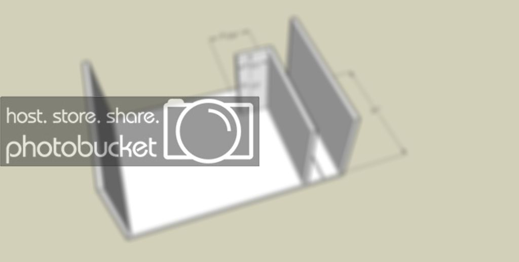

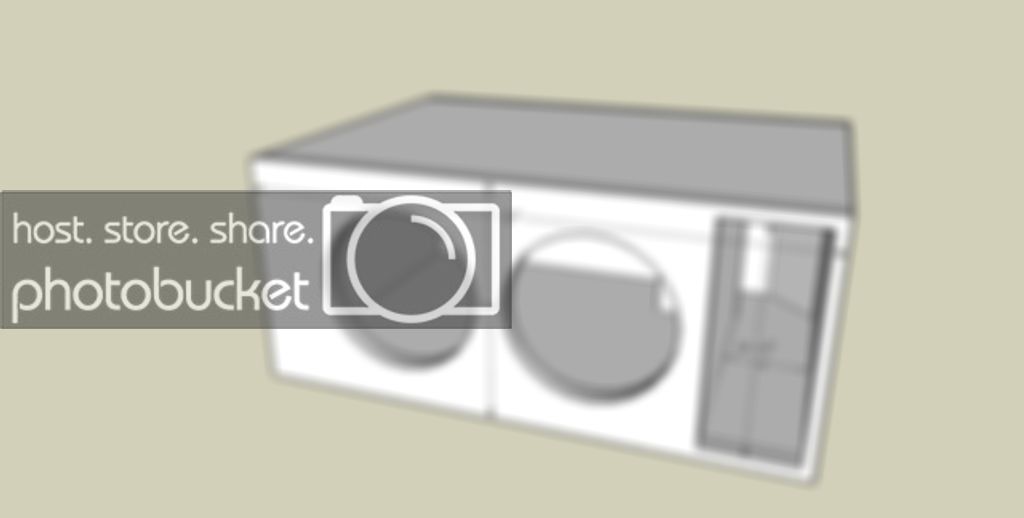

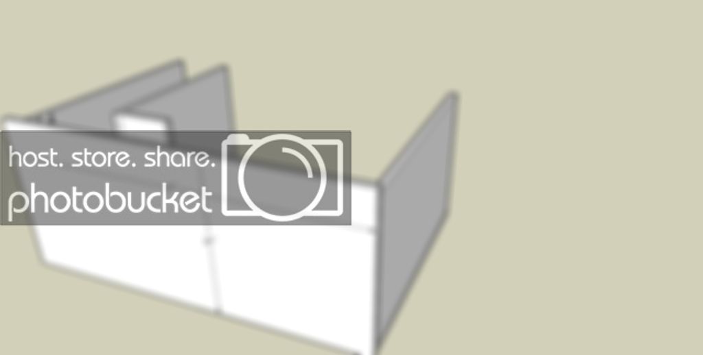

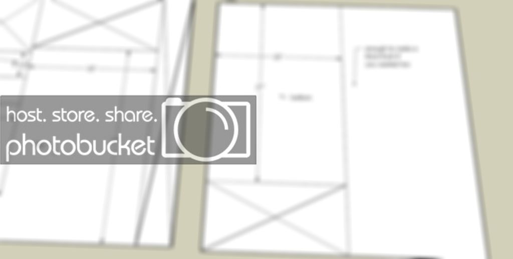

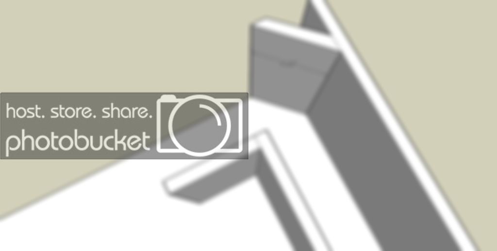

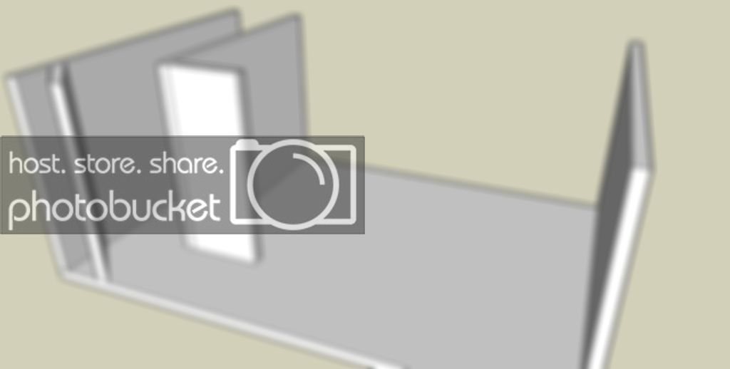

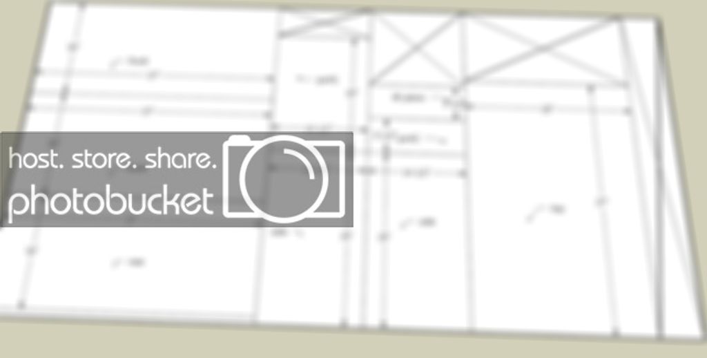

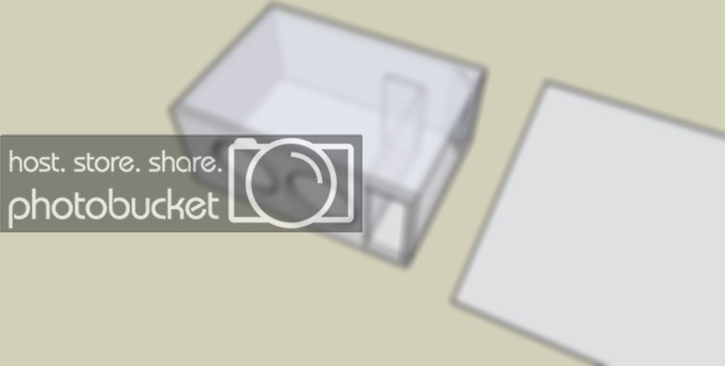

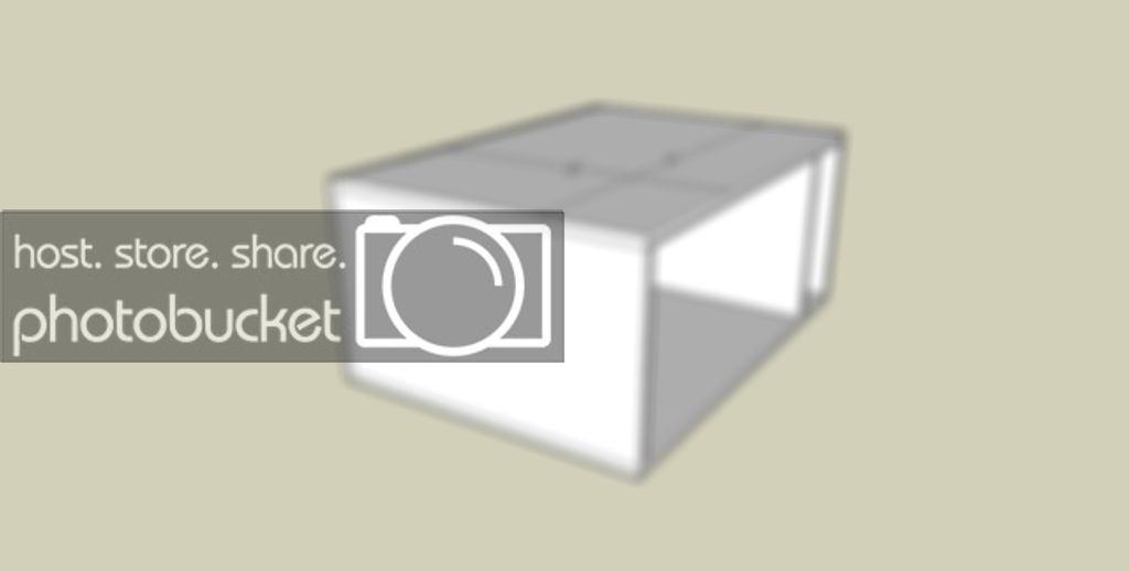

Need Box Design for 2 12" DD 9512g
got another 5.415 tuned to 33.16 HZ after sub displacements
bracing wont effect enough to matter.....volume will go down less than .1 and tuning will go up less than 1 hz

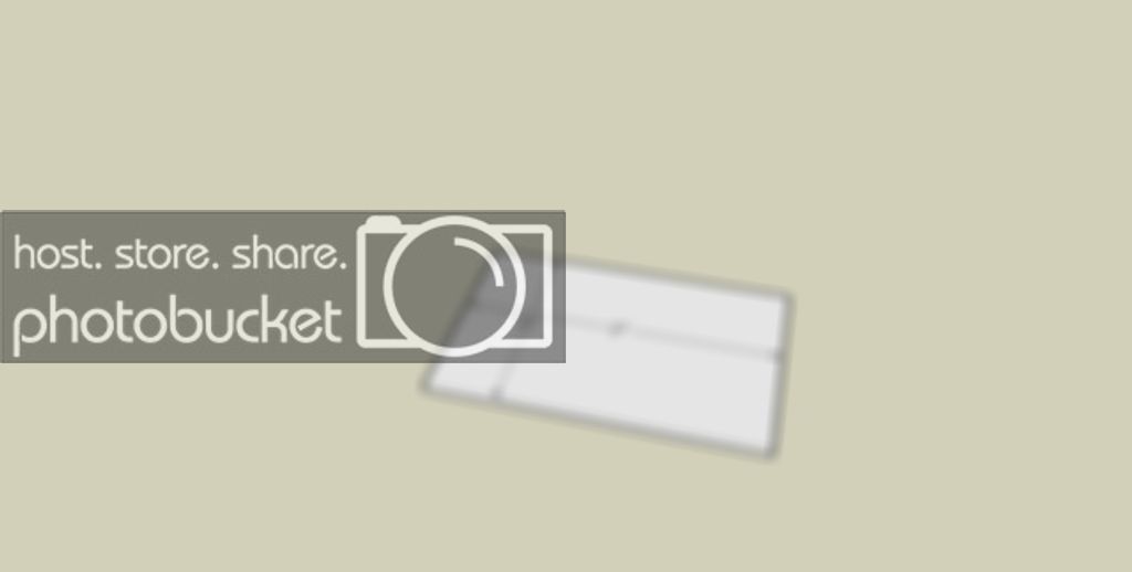

top 37 x 25
bottom 37 x 25
side 14.5 x 25
side 14.5 x 25
front 37 x 16
front 37 x 16
back 37 x 16

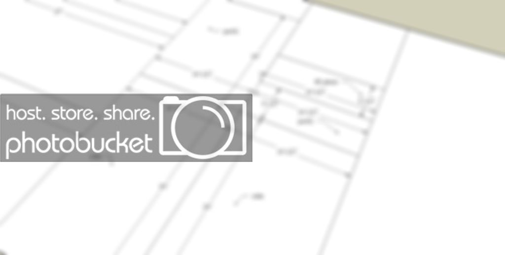

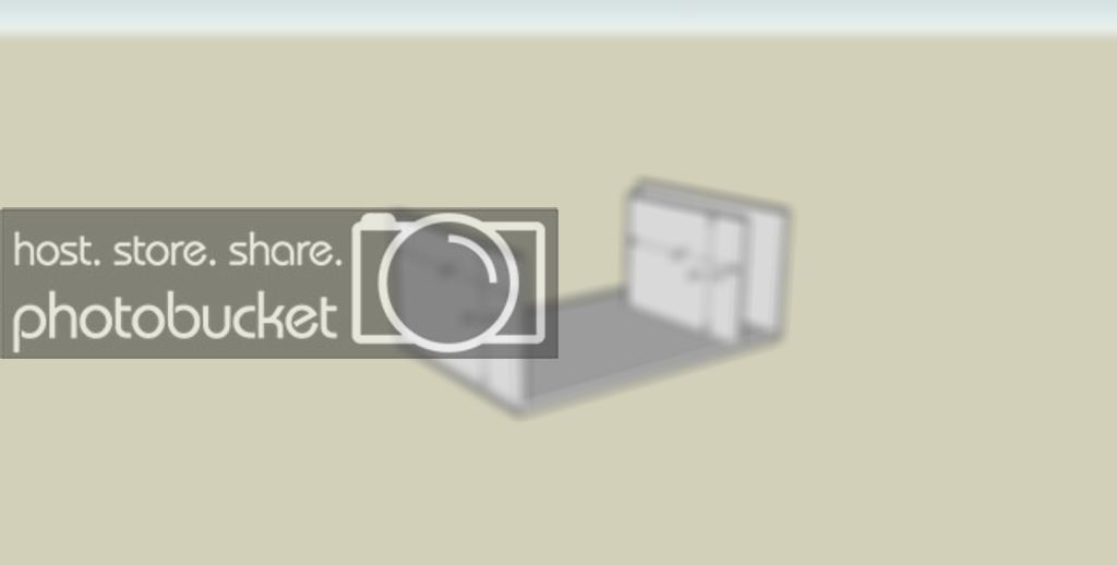

port1 14.5 x 19
port2 5.5 x 14.5
45 = optional 5.5 x 14.5 (wide corner)
I just ran these dimensions on RE AUDIO box design program and its coming up to equal only 4.562 cuft!!! IS RE wrong or is this design wrong????????? Please Help
i just ran it again, i get 5.69125 minus the subs displacement will net you 5.39 cubes
when i reverse engineer it in winisd i get the box tuned at `43.79 which is .06 hz off the inital tuning of 43.85
