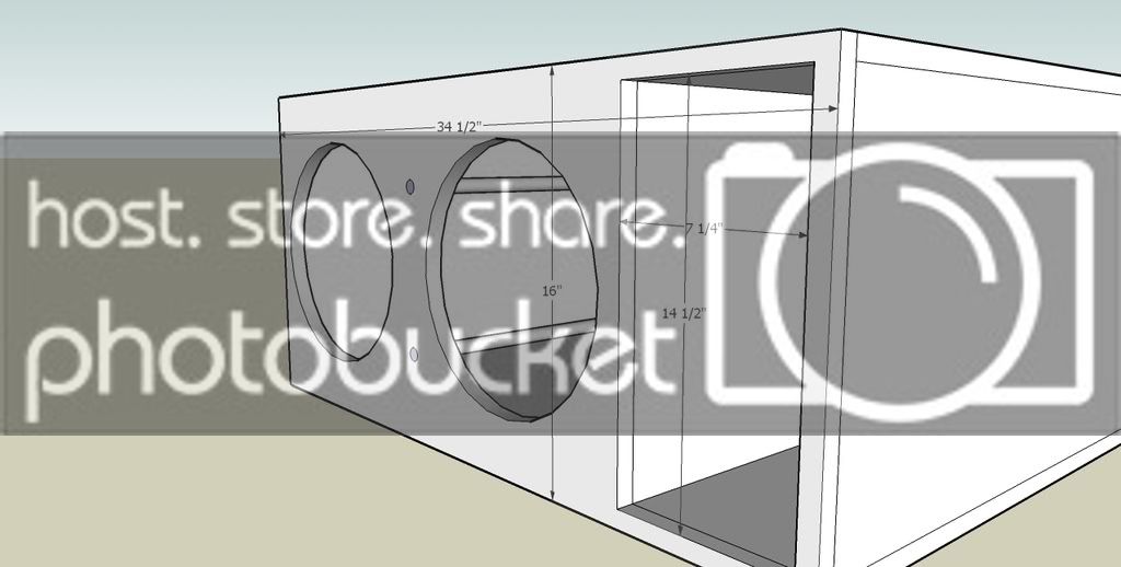

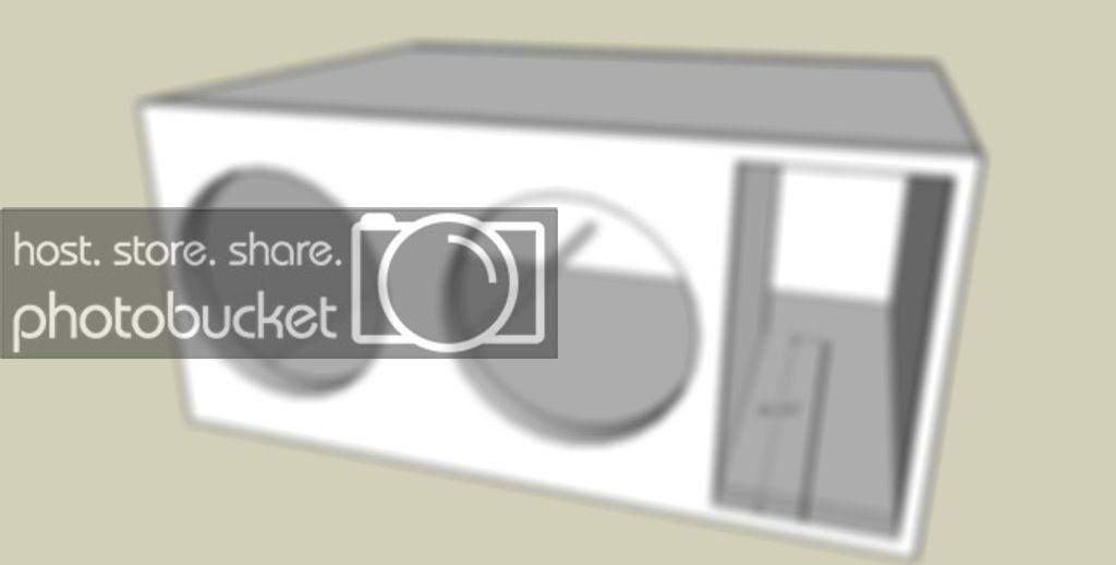

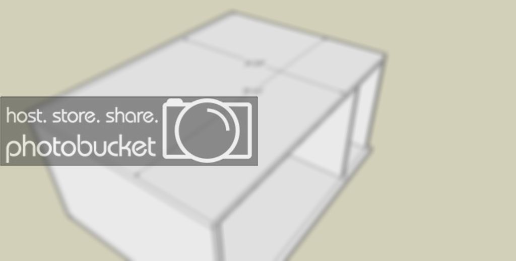

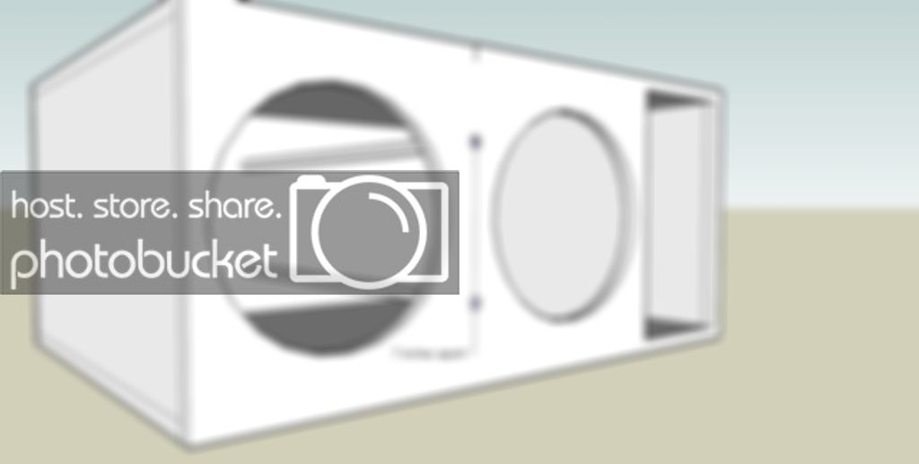

Basically, what your looking at is a 6.39 cu^ft box (including the MDF)
36.25 W x 17" H x 22" D
5.27 cu^ft airspace + 1.12 cu^ft of port
No bracing accounted for, must be a single port to work.
The port would simply be a .75" by internal box width (3" x 34.75")
piece of MDF that is 14.83" deep. No L required. I would need to
recalculate for bracing.

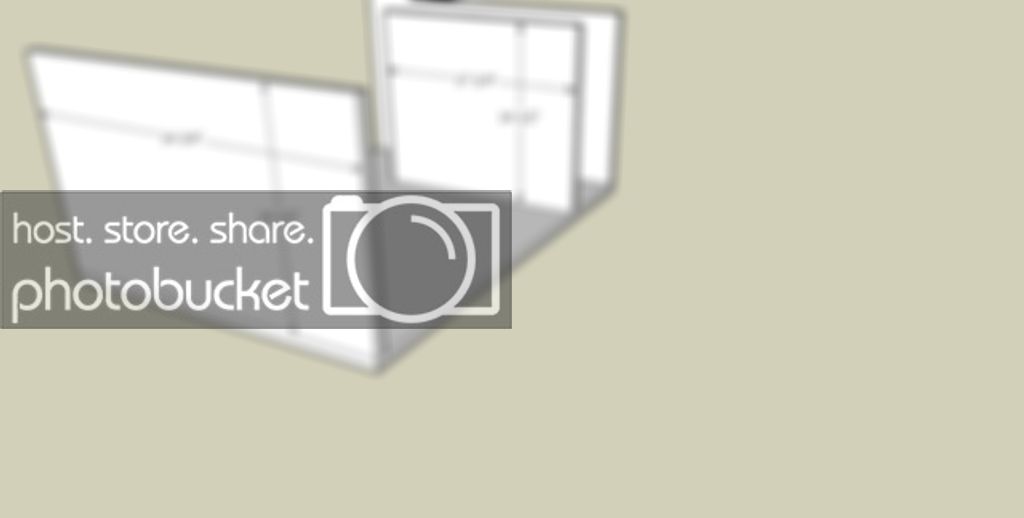

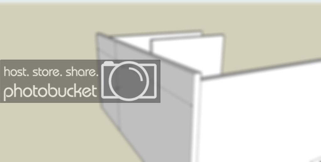

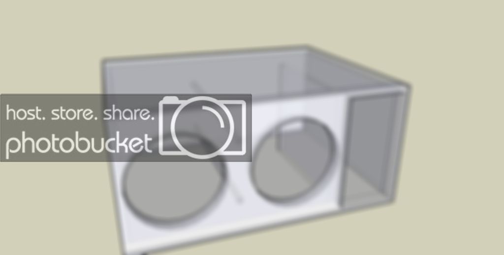

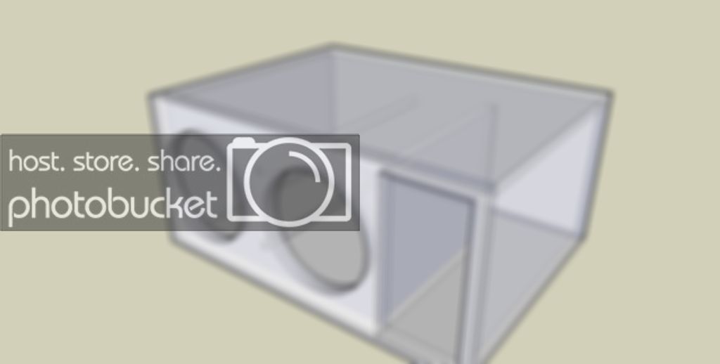

still working it homes, its done, just doing the model now.
tuned really high....
but it should get down very loudly.
just be careful under 35 HZ
p><p>

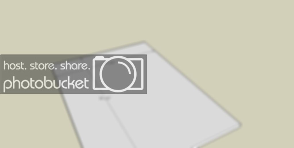

Top 24.75 x 34.5
Bottom 24.75 x 34.5
Side 14.5 x 24.75
Side 14.5 x 24.75
Back 16 x 34.5
Front 16 x 34.5
Front 16 x 34.5
Port 14.5 x 17.25
its 5.392 cubes @ 43.85 HZ
