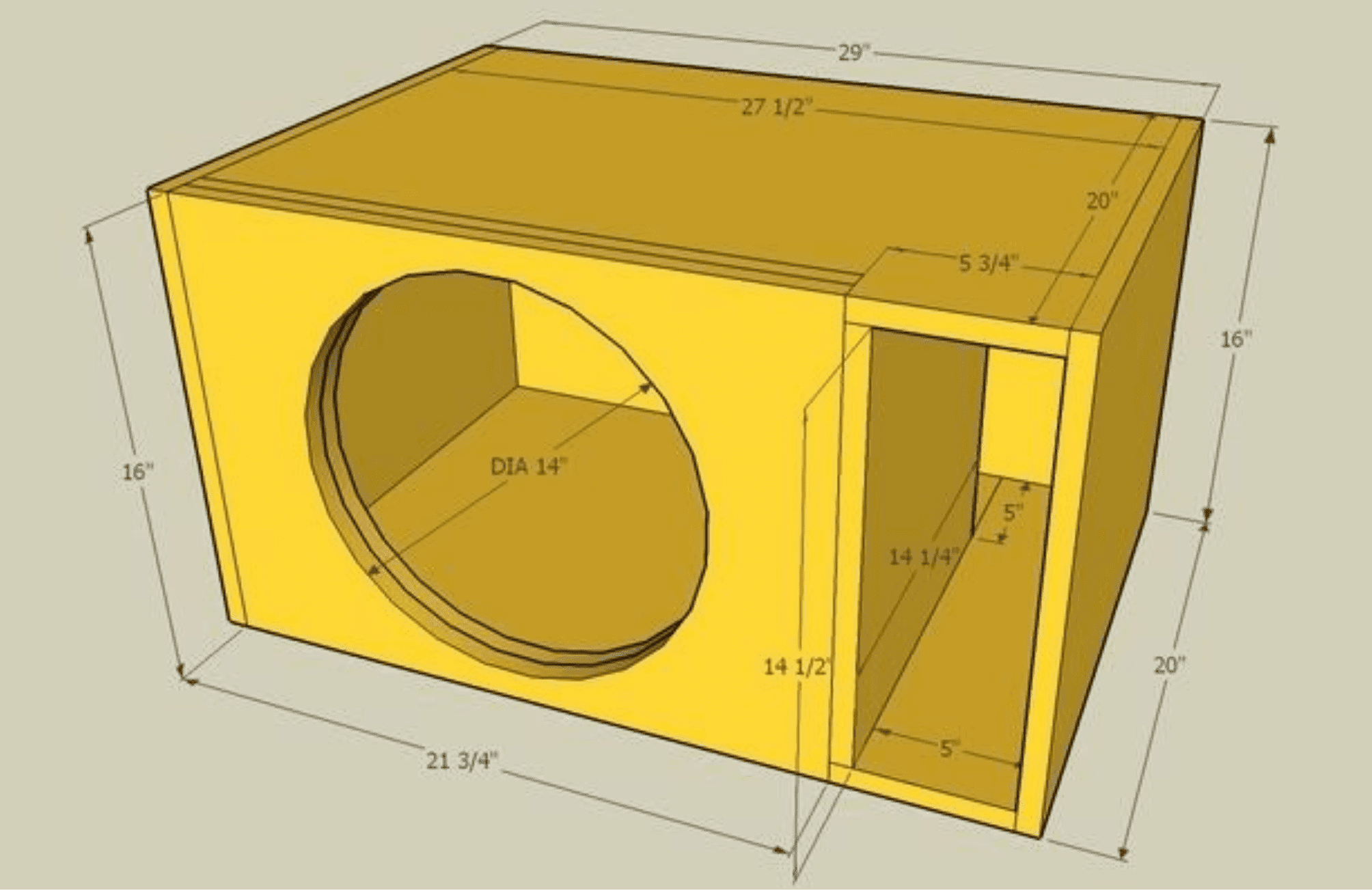

Would this be good? Or the one in the picture if I just cutout it for a 12 instead of a 15?
