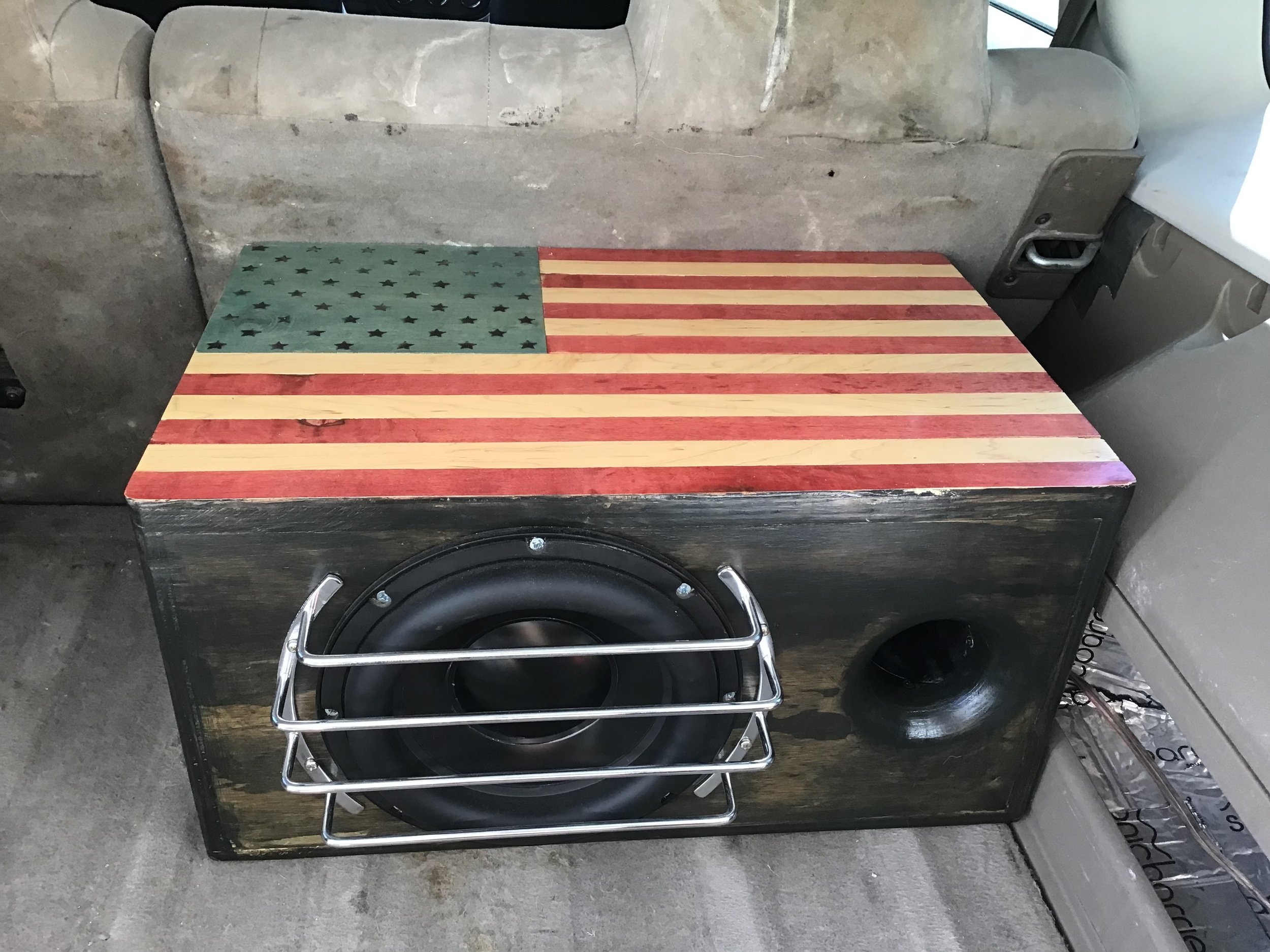

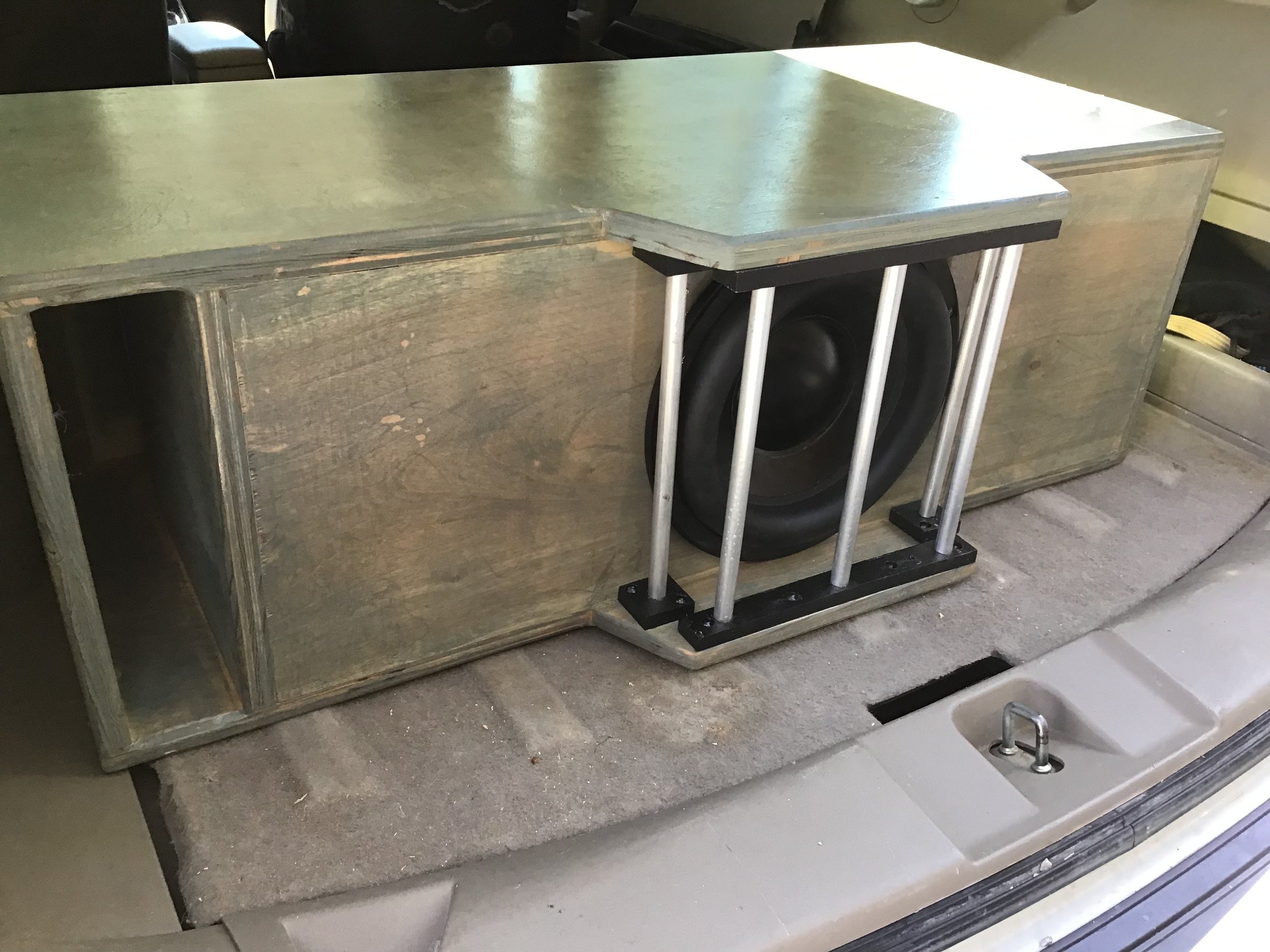

aeroports cut down on space. This is the same sub and same box specs. Both of these boxes are 1.3 cubic feet tuned to 32 HZ. You can see the size difference. The slot port takes up over 1 cube of space inside the box by itself. The round ports HAVE to be flared on both ends or there would be a lot of port noise though. I just did a custom box for an AB XFL 12 a couple weeks back. 1.8 cubes tuned to 34 HZ. Very impressive sub in a ported box. I would recommend to anyone running this sub not to run it sealed. It won’t do as well as some other subs in sealed boxes. The Dayton ultimax 12 or Stereo Integrity 12 would be an excellent choice for a sealed setup. Either of those would love a sealed box.

aeroports cut down on space. This is the same sub and same box specs. Both of these boxes are 1.3 cubic feet tuned to 32 HZ. You can see the size difference. The slot port takes up over 1 cube of space inside the box by itself. The round ports HAVE to be flared on both ends or there would be a lot of port noise though. I just did a custom box for an AB XFL 12 a couple weeks back. 1.8 cubes tuned to 34 HZ. Very impressive sub in a ported box. I would recommend to anyone running this sub not to run it sealed. It won’t do as well as some other subs in sealed boxes. The Dayton ultimax 12 or Stereo Integrity 12 would be an excellent choice for a sealed setup. Either of those would love a sealed box. View attachment 51936View attachment 51937
Those are some Badd Azzed looking enclosures man. Love It!! 👀 👀 😚 😚
