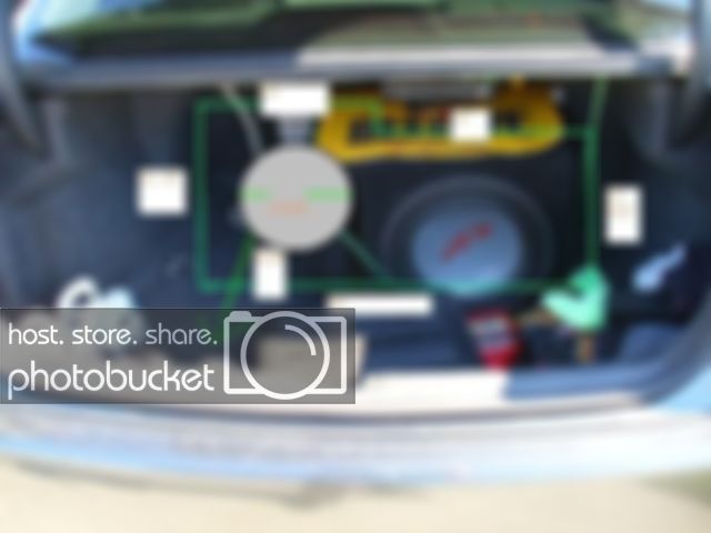

Here's a pic of the trunk with a sketch of the space I have
The ones with ##-##, I prefer the smaller number, since there is a bar near the rear seats that is lower than the trunk height, if you make it the lower number, I can have the box go under that bar, if it is higher, i will just have to make it in front of that bar, therefore the box sitting farther out away from the rear seats. Hope this is clear enough :\ wasn't too sure how to do this, if you need any more pics just lemme know

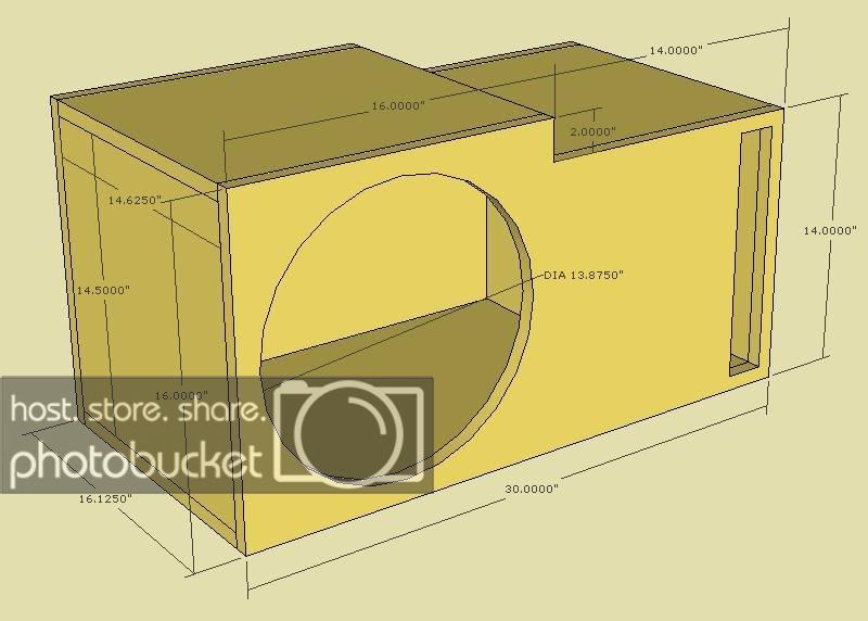

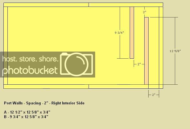

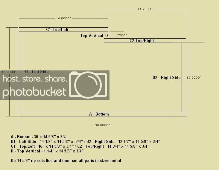

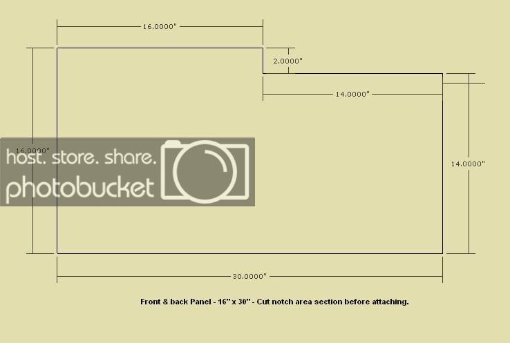

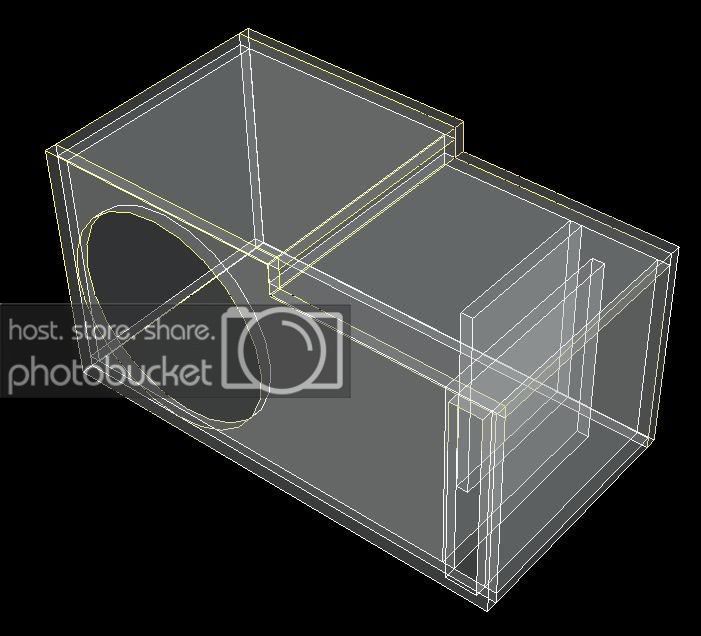

I'll have something for ya in an hour or so and post if back here and so the moochers can scam it:p:
Phil that all looks good, I will probably be sending you a PM in the next couple weeks because I need to start my new build. Let me know if your interested...
just a lil word of advise if u just put the front and rear panel on with out cuttin the knotch out u can router it later and it will be perfect conformed to the knotch
