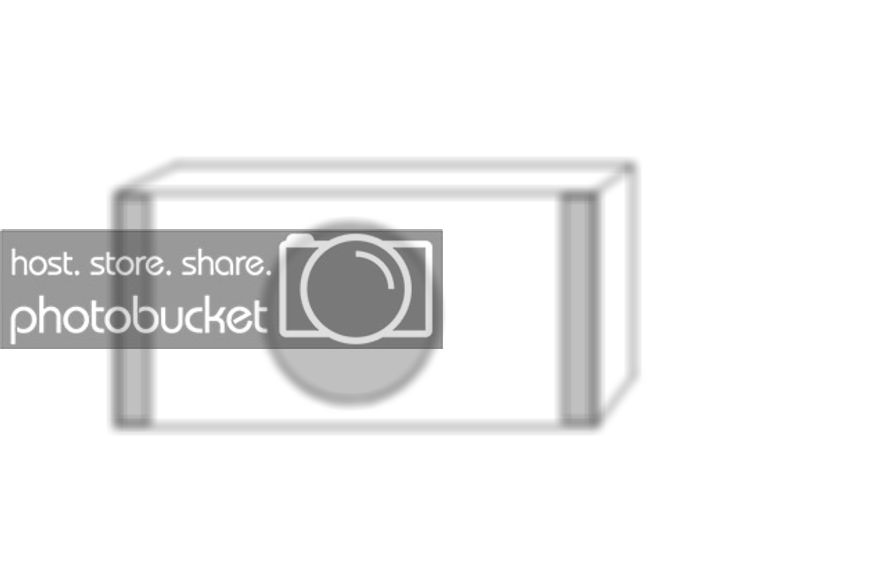

I am going to have a Soundsplinter RLP-18 that i need a new box for.
The space that i have available is 48" wide, 26" tall, 12" deep top and bottom. these are all max measurements, they can be less if needed.
I would like to have two slot ports on the each side of the box (front side). 1 port is ok if thats my only option for tuning to 28 hz. I cant seem to get what i want on RE enclosure designer.
this is something like i am looking for:
can someone design a box like this tuned to 28 hz?
Using your dim and a port 2.5"W x 24.5"H x 36.5"L (61.25 in^2 of port) You net 5.09 ft^3 before driver displacement tuned to 28hz
To tune as low as you want and keep within your space requirements that is the most I could get. If you have a little more room to work with a little larger wouldn't hurt
If youre interested in buying an enclosure design I could see what I can come up with. If you want, Ill design it, sketch it up. Then if you like it send $15 to me and Ill give you step by step pics and a cutsheet.

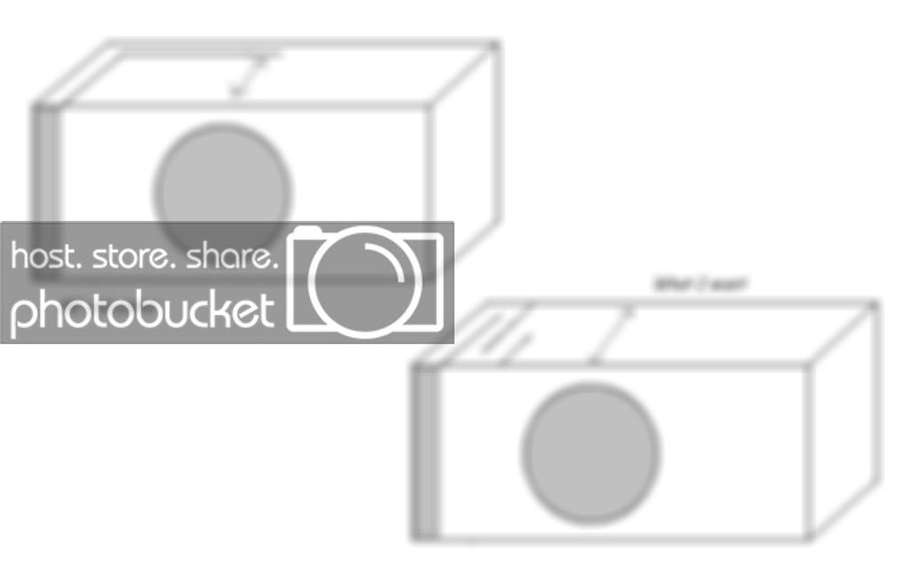

also, i was playing around with the RE Enclosure calculator, but the port is always in the same position and you cant adjust it..
heres a pic of what I came up with on RE and more of what I am looking for because of mounting depth.
Can someone design a box like the second one in the picture tuned to 28-30 hz netting around 5 cubes with my measurements... ( 46" wide, 25.5" tall, 12" deep
I can do it like that but the problem is with your max dimensions and wanting to have 5 ft^3 net your port needs to be smaller to get the tuning you want.
More port area = more port length = more port displacement = less net vol.
70 in^2 would be a pretty good size for you I think but then you would need to make the port longer and you would only end up with about 4.5 ft^3 net.
