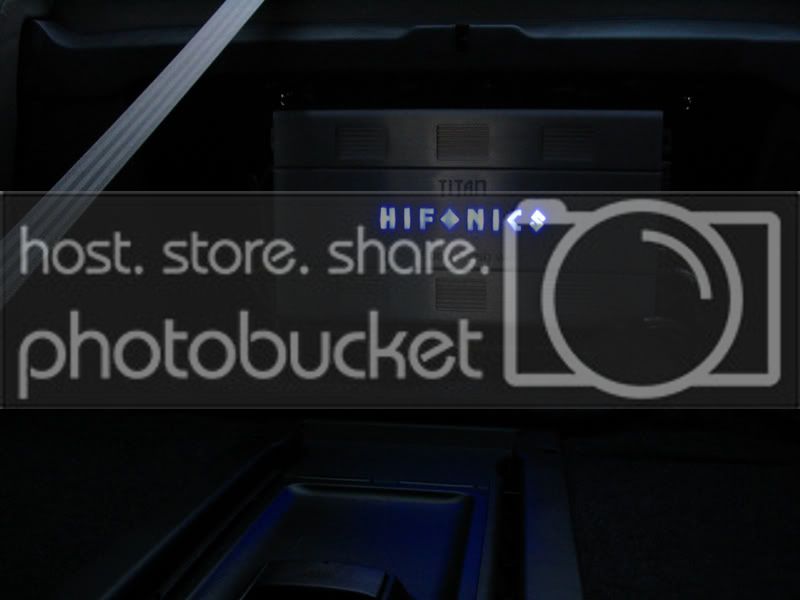

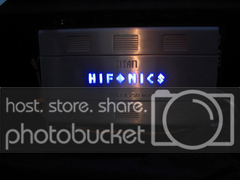

i didnt say i needed a shop for an install........ im looking for a shop that can bench test my ampfor what? install the shit yourself. It will save you a ton and the experience is invaluable
yea its a small audio shop run by some people i know... anyone know if Bestbuy would do bench tests?I take it that shop doesn't have the necessary equipment to bench test? I know my local shop doesn't. You might have better luck looking at bigger shops rather than neighborhood shops.

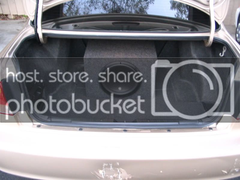

quick question though.. the guys that installed my subs have set all the gains and settings properly
but they set the subsonic to around 45hz, im guessing... it ranges from 15hz-55hz
just wondering if i can lower it to around 26hz or so because i have a sealed setup
HU is stock unfortunatly... i wont be getting a afternarket HU til feb.Set your Bass EQ to 0 or off.
Set your subsonic filter to 20hz. Since you have sealed it defeats the purpose of using one but i whould still set it to 20hz just in case.
Set your LPF to 80hz
