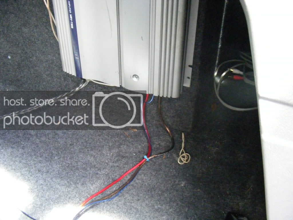

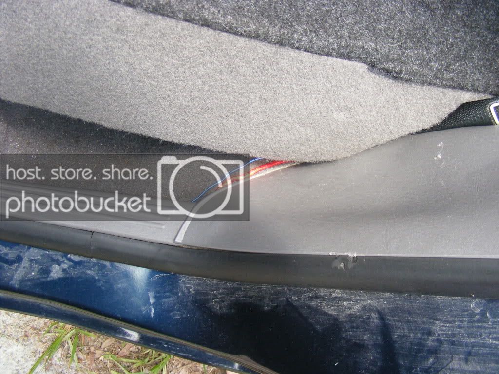

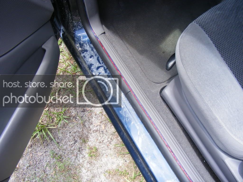

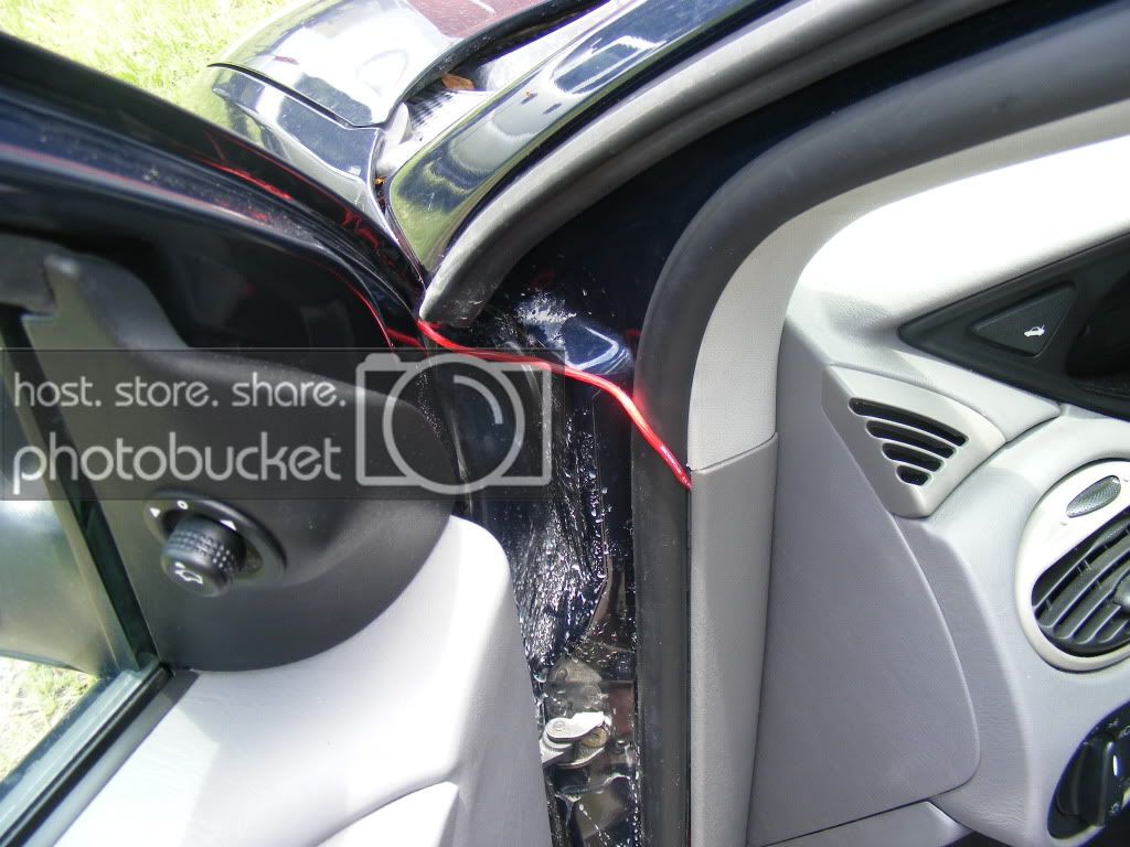

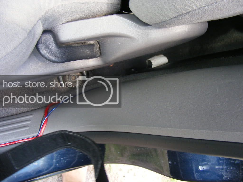

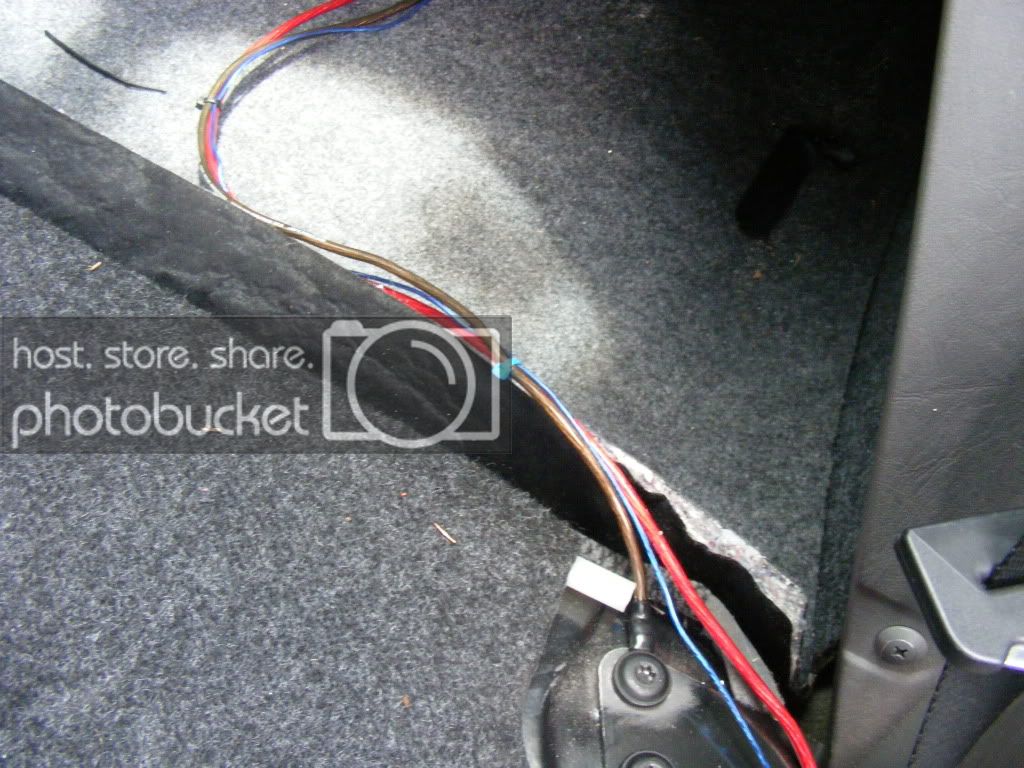

heres my wiring job less ghetto than b4
You *NEED* to get your wires away from the door jam.. That shit is going to get pinched.. You have it pinched on the plastic.. That plastic can cut it.. The interior panels shift and move and rub as you drive the car..
Your power wire is thin as hell too.. How many watts?
I don't see any fuses anywhere?

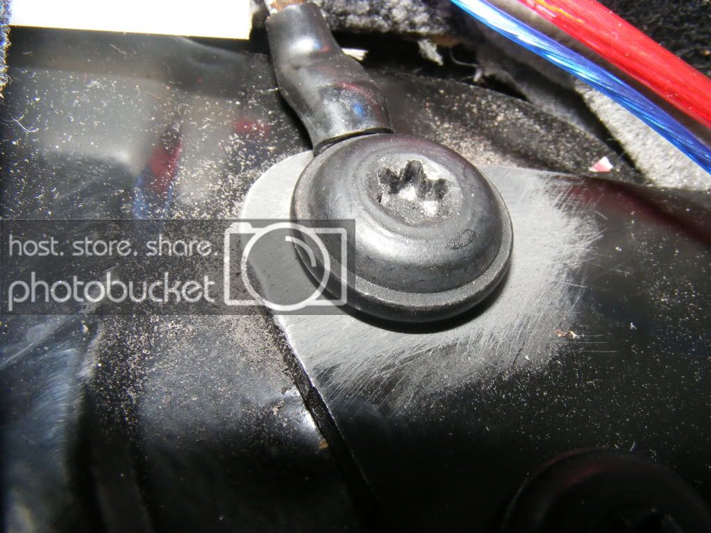

I bet that ground is horrible also.. I'd check that..

You should meet up with him to run all new wiring and get a new box..
You need that NOW not when you get new stuff and then when you get new stuff you will have the wiring done already..
