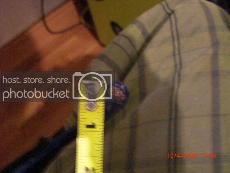

Asking for clarification and pictures if possible OP.
on the 2/0 thats wat it says on wire the 4 says 4 awg it is out of a amp kit i got off my buddy there like 12-14 foot there and i got the 2/0 from the local welding shop theres like 30 foot of it
how do u post pics
Upload them to a website (My favorite is Photobucket) then click on the little portrait picture on the toolbar of the message and put in the link.
