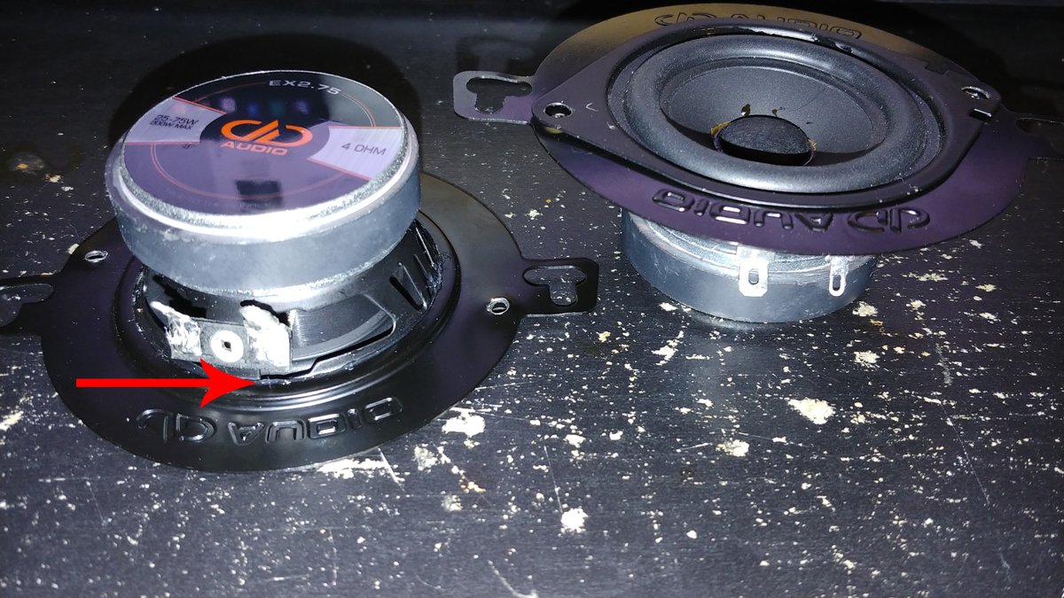

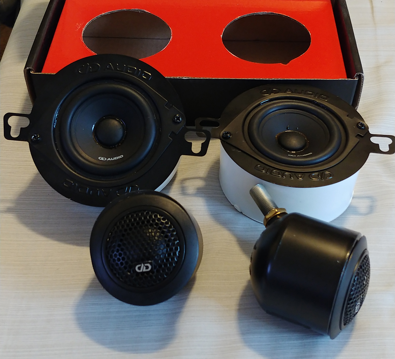

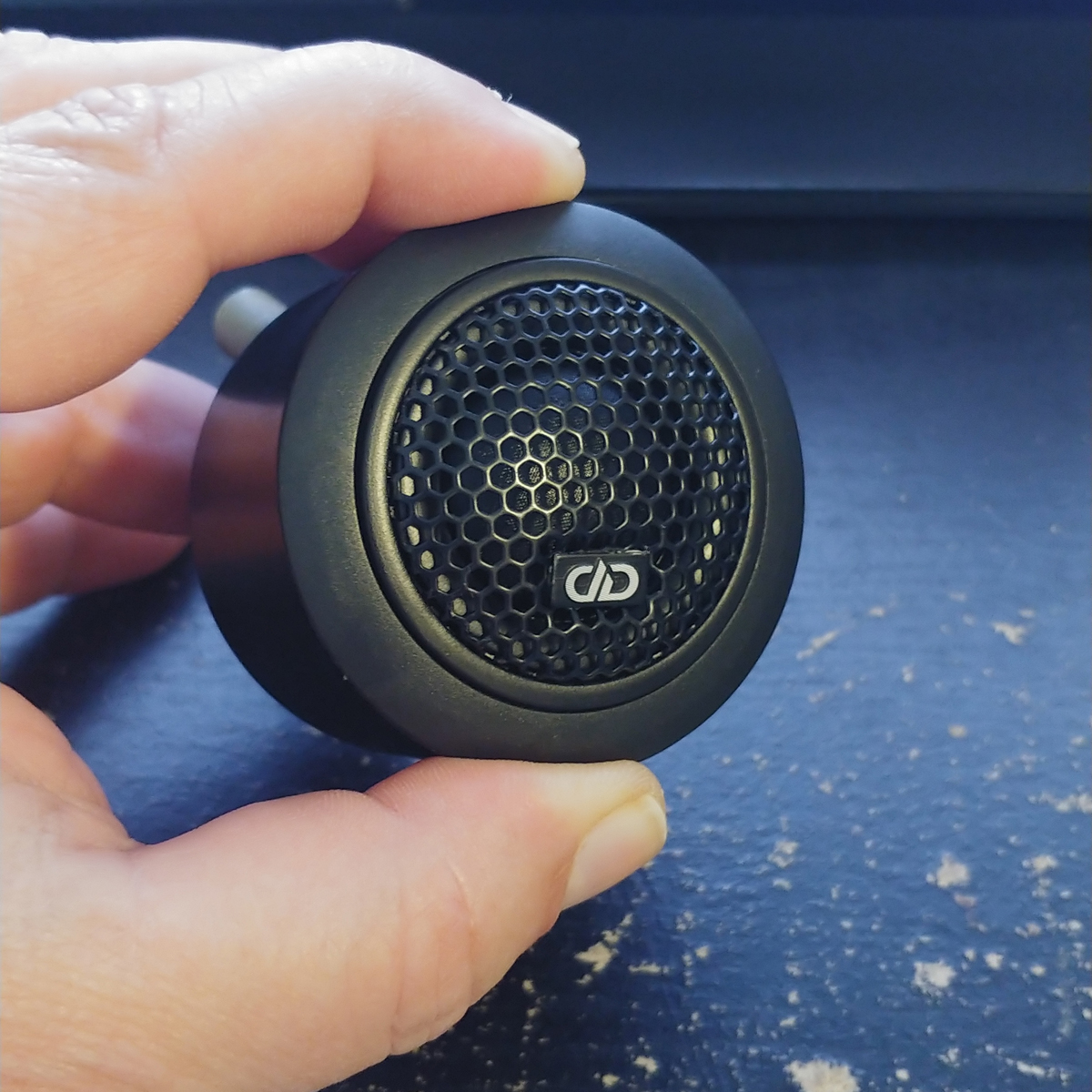

My DD 2.75" mids seem to be just fine. I have 3 sets of tweeters, 1 set running in the car as I speak (ARC Audio 1.0), 1 set of DD soft dome tweeters and a set of 25mm Titanium Dayton Audio tweeters. The DD's and the Daytons are brand new and unused. I am going to make some more pods out of PVC caps. 3" to be exact for the DD 2.75 mids. I still have a two channel amp sitting here in my room... my RF 250a2. I am going to run my silverflutes on it and the 4 channel barbara ann will run the mids and tweets in the pods on the A-Pillars. This will be a final test/learning experience in THIS car. If this works like it is supposed to then I will apply all this to the next car... next Jeep Grand Cherokee 99'-04'.
SkizeR, I am going to stack the tweeters above the mids vetically at the A-Pillars... Suggestions? Words of advice? The mids and tweets will be ON AXIS. You know the speakers I have:
6.5" Silverflutes - 4ohms - Midbass
2.75" DD - 4ohms - Mids
ARC 1.0 - 4ohm Tweeter - Soft Dome
Digital Designs T2a - 4ohm Tweeter - Soft Dome
Dayton AN25Ti-4 - 4ohm Tweeter - Ti Dome
Which tweeters should I use? Can you list crossover points for each? I have the sub running up to 65hz 24db L/R slope. I have the Silverflute midbass starting at 80hz 24db L/R slope... from there I need the best suggested starting points. Whatta ya got? All active brother.

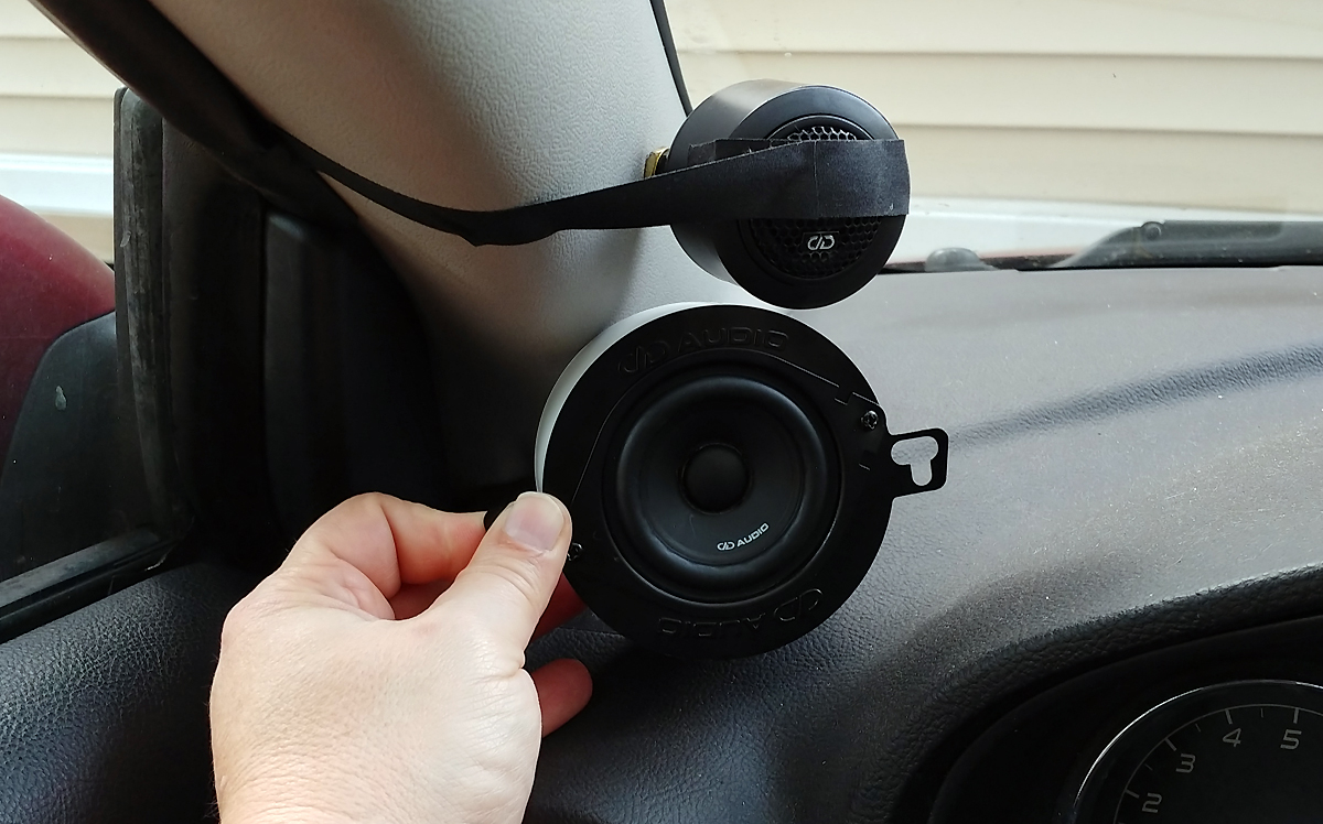

Found my A-Pillar pods I made for my Alpine tweeters and was able to remove the tweeters. I test fit both the Dayton's and the DD's and they both fit with no issues. I don't know... they both look good.

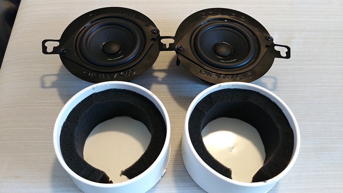

Ok, I got some more PVC today... the pics should give you the basic idea. These are CHEAP diy pods but should be effective. All drivers will be sealed in their pods so front and rear waves should not be an issue. I guess I will use the DD speakers for this experiment. I also included a mockup pic.

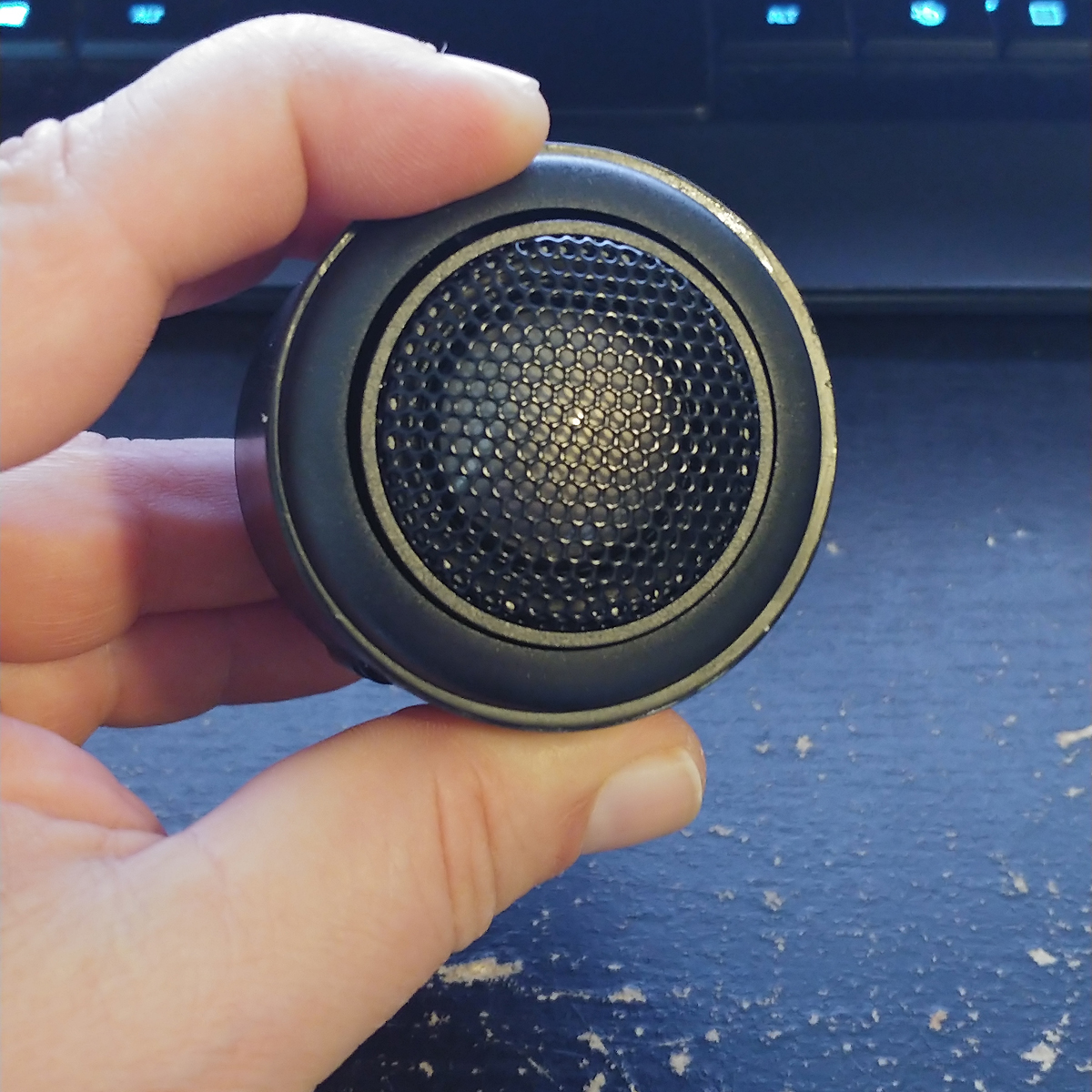

I think one of my ARC tweeters is either blown or has a very loose connection. Cuttin in and out all night. Very annoying.

Putting the pods together for the widebands. That foam is some left over Stinger Fast Ring material. I am hoping it will dampen the inside of the pods. To comment on the pods size, they are actually almost exactly the same size as the factory door panel pods 3.5" location which are also sealed pods. The 2.75" sounded fine in those with no foam. It is an experiment. These are going up on the dash, angled at the drivers head...ish.
