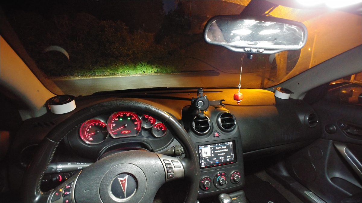

I had it crossed over at 300hz but that was before I lowered the mids 6db. I will put it back and see if the midbass are still there, I suppose they should be now. Right now, I am literally just trying to learn what different situations sound like in the car. I have never had speakers on the dash like this and active. Here are the pods... don't laugh too hard, it is an experiment. I am looking at some prefab pods that fit may A-Pillars and that fit up to a 3.5" and 1.5". Those aim the drivers at the headrest. As you can see, these are off axis... but they are friggin loud.

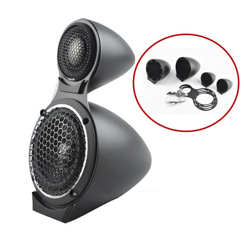

I bought them because like the Kicker pods coming out next year, the tweeter housing can be rotated around the mid. I was sold.
