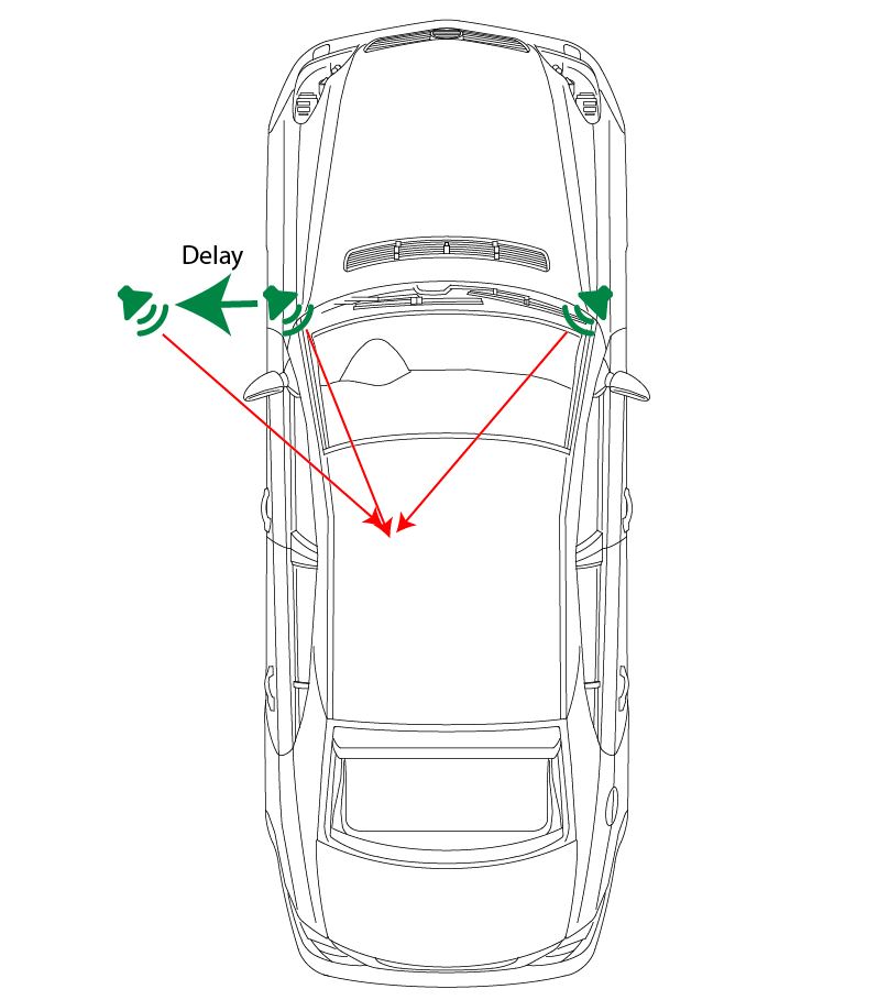

I am measuring from the speakers to my left and right ears making the circle of sound around my head which makes center in front of me by default. Literally my goal is to make the stereo sound as if I have the left side speakers mounted outside the car, the same distance away that my right speakers are... see example image 1a.

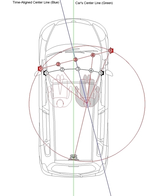

If I read you correctly, what you are saying is correct imaging is example image 2b. Forgive the right hand drive image, just flip it lol. It has the center of the car as the center of the soundstage which again, puts the singer to one side... I don't know why people call this a true center image. It should be called a true skewed offset center image. To make it actually centered, I would have to rotate in my seat to face the center by several degrees. Like going to a concert and sitting to one side of the stage. Again, my opinion is that the sound should be front and center. If I am at home, I sit directly in the middle of my speakers... not to the left at an angle.

1a.
2b.
Thats not how it works. Your left and right boundaries are dictated by the speaker locations and the reflections that are associated with them. Sometimes you can get cues that make it sound like its a *LITTLE* bit outside of the car, but no, you will never have a car that has a center image in front of you that has equal distance between left and center and right and center unless the seat is in the middle of the car. Center is center of the stage, which will almost always be center of the car. If you tune properly, this is where it will end up. If your center is ending up somewhere else, your tune isn't correct and there are at least 3 other things that are compromised in order to have that center image location. Dont do it. It doesnt sound good.
