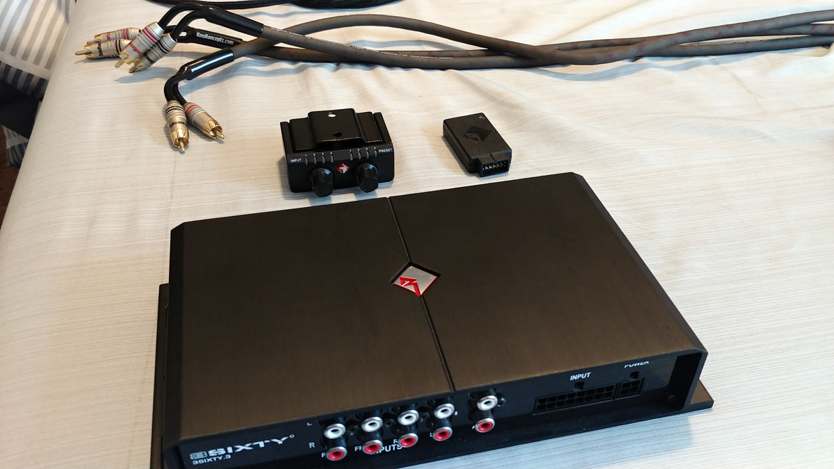

My first "Active" "SQ'ish" build attempt.
Ahhh, now I know why it sounds different. I guess the DSP pushed an 8v signal to the amps whereas the head unit at max volume may hit 4v to the amps... That explains why I can max the volume and it sounds super clean but not very loud lol. I am off Monday... I am charging the laptop battery now, the DSP will go back in Monday and now I know it is going to be stupid loud.
So far no rain... time to put it back in.

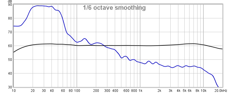

Gonna go 0db to get the input signal then -5db @4Khz, -5db @1Khz, -10db @40hz. I will follow all this up with the miniDSP Mic and some pink noise for the equalizing.

I measured today and I was dead on. The tweeter is exactly 12 inches above the midrange in the lower door. The tweeter is flush mounted to the door panel however the VC of the Silverflute is easily 4 inches behind the panel. If I am comprehending what I have read, I need to make the delay of the midrange and the tweeter to my ears about as dead on as I can... another words, measure as precisely as I can, the distances of those door speakers and re-enter them into the DSP and switch to a Linkwitz-Riley crossover at 24db. Because the distances to the speakers in the right door have less of a deviation in distance to my ears, I am hearing less separation of the speakers... meaning they sound more like one speaker and image is higher because the tweeter dominates. This should get better once I re-measure and set the delays and change the crossover.
I am guessing I will have to measure with the MIC again and re-EQ as there will be some change in the dips and peaks. I have to say, currently, it is LOUD in the car, the right side is out there and vocals land just to the slight right of the center of the steering wheel. Ref. Dwight Yoakam, Radiohead, Inya, and a few others. I haven't finished reading the whole link but I will. I am tired at the moment. I will post what the re-measurment and crossover change if anything tomorrow before I go to work.
Thanks SkizeR
I re-measured all the speakers and I also confirmed the distance of the mids behind the door panels. 3 inches. The left mid was off by a good amount... I don't know where I originally measured that speaker to, it was dark outside. This time I measured to the center of the grill and added 3 inches to the measurements for the mids.
I changed the crossover types to Linkwitz-Riley @ 24db slopes.
I then put in my IASCA tracks and verified (Left, Center, Right, In phase/out of phase) I then played the 7 snare drum track where it pans 7 snares from left to right 2x in a row. Height is flat now at the tops of the door panels and across the dash with the single snare drum hits. I don't know if this was supposed to happen but the tweeters sound brighter. I played track 7 "Gavotte in D Minor" and it sounded GREAT! It is a very wide stereo image track with drums, piano and other instruments. I will test it out more at work whilst I deliver the pizza. :)
