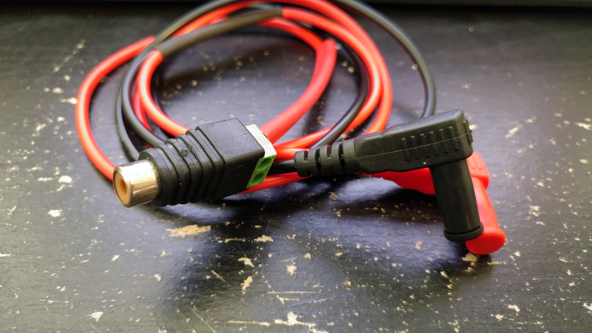

Since I can't get a straight answer about my head units pre-amp output voltage I made a test lead for my DMM/O-Scope. I hear my head unit is clean to full volume but my DSP says it's clean to 36 out of 40. So I made this. I have another set of leads and a male connector, though I am not sure what I could use the male RCA connector for.
