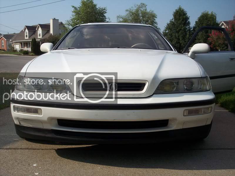

Headlight upgrade. I retroed some tsx projectors into custom one jdm lights. For the cost, cutoff and color tsx projectors are the way to go.

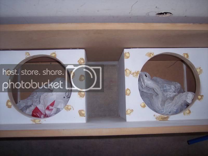

Added 1st coat of primer, removed screws which would be visible from back & then filled in the holes.

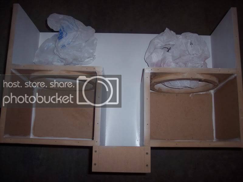

Caulked the edges of box to make sure its sealed.

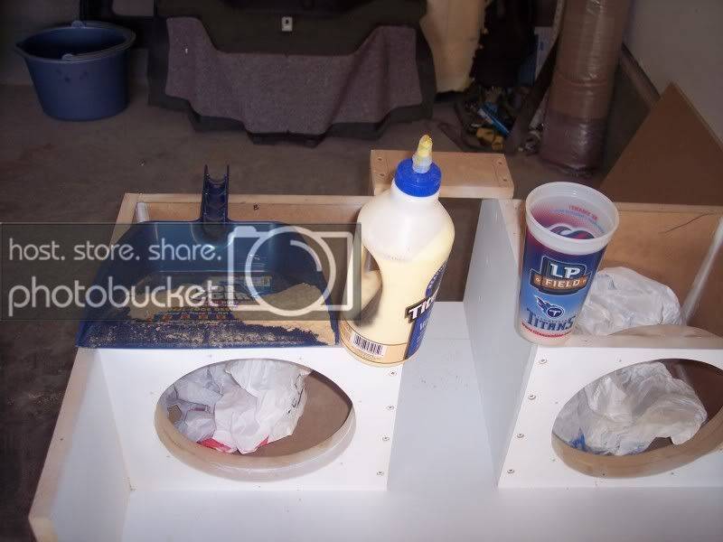

After sitting over night drying, sanded to get ready for more primer.
Added 2nd coat of primer. mdf soaks up alot of paint so I will be doing 3 coats of primer, 1 coat of white paint and then a final coat of red paint.
