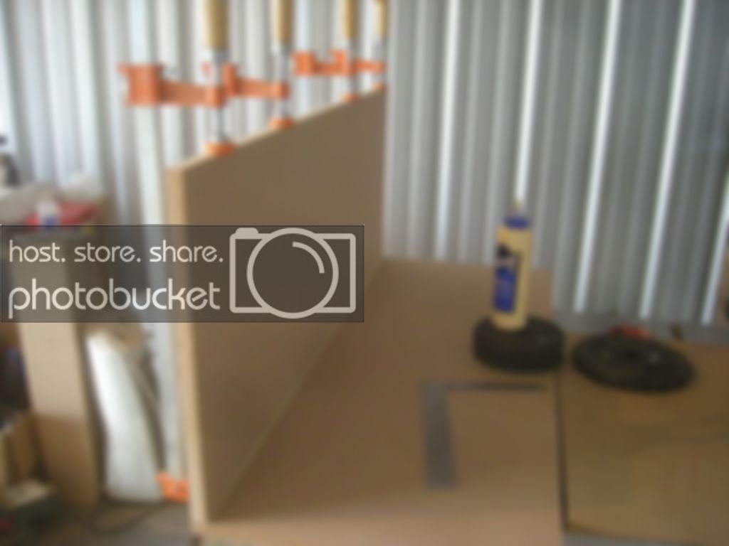

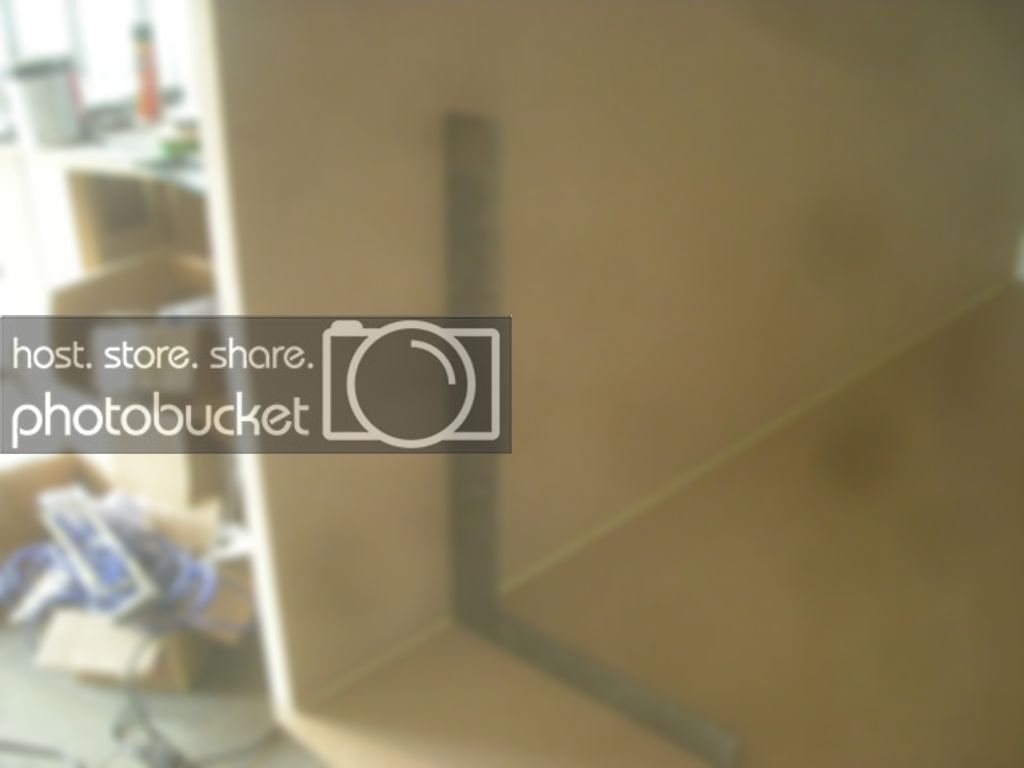

This enclosure will be for a 15" AQ HDC3. Specs come to 4.125 cubes net, tuned to 35hz, with 66 sq inches of port. I got a little started today, more tomorrow.

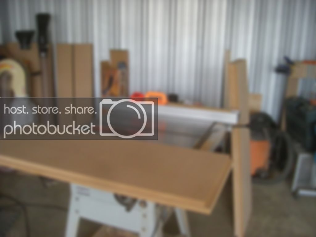

Getting the pieces cut..

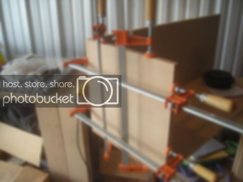

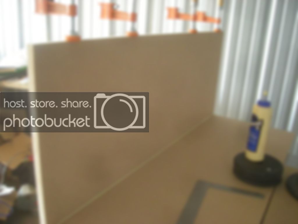

Back going on..

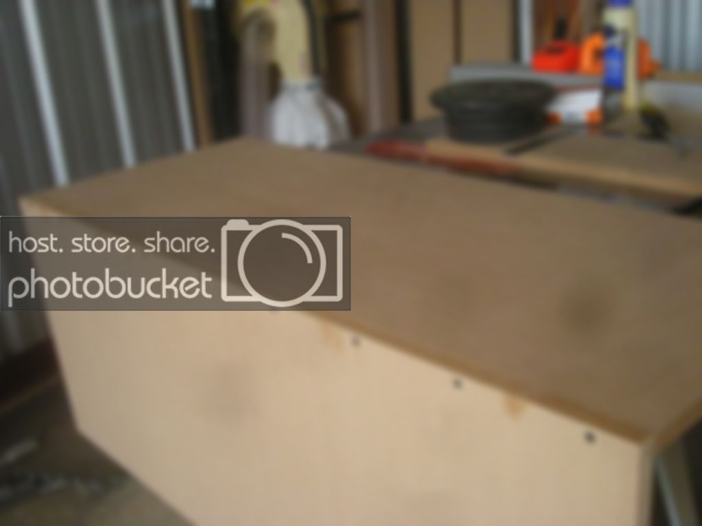

Side going on..
